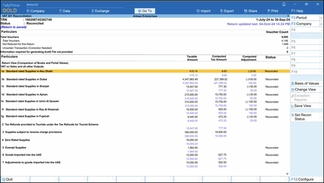

  1. Press Alt+G (Go To) > type and select VAT 201 Reconciliation.
    vat-201-reconciliation
    The report displays the section-wise comparison of:
    • Values as per Books
    • Values downloaded from the EmaraTax Portal
      Each section shows its reconciliation status based on the comparison. TallyPrime automatically detects whether a section is Reconciled or Unreconciled based on the difference between the values.
      Only sections that display values are considered for comparison in the VAT 201 Reconciliation Report.

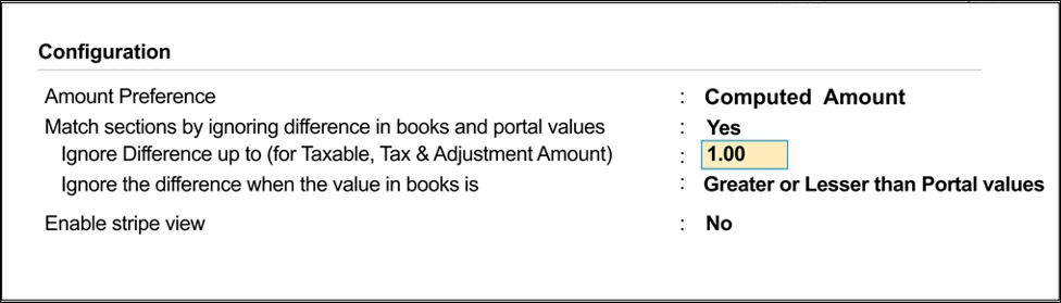

    1. Set the Amount Preference.
      By default, the report considers the Amount Type selected during the upload of the VAT 201 Return from TallyPrime. You can change this if required.
    2. Adjust differences in Transactions during Reconciliation, if required.
      If you want TallyPrime to ignore minor differences in values between your Books and EmaraTax Portal, and consider the transactions as reconciled.
      • Set Match sections by ignoring differences in Books and Portal values to Yes.
      • Ignore Difference up to (for Taxable, Tax & Adjustment Amount): Enter the maximum difference that can be ignored for each section. Any variation within this limit will not affect the reconciliation status.
      • Ignore the difference when the value in books is: Choose whether the difference should be ignored only when the Books value is Greater, Lesser, or Greater or Lesser than the Portal value.

View Reconciliation Status of Transactions
By default, TallyPrime automatically determines the reconciliation status of the VAT 201 Reconciliation report based on the reconciliation results of individual VAT sections.
The report can display one of the following statuses:
  • Reconciled:
    • All relevant VAT sections are reconciled.
    • Minor differences are ignored as per the reconciliation settings.
      This indicates that the values in your Books and the EmaraTax Portal are aligned, and no further action is required.
  • Unreconciled:
    • Differences between Books and Portal values exceed the configured tolerance limits.
    • One or more VAT sections remain unreconciled.
      You must review the affected sections, verify the vouchers, and update the data if required.
  • Manually Reconciled: When you manually reconcile transactions by pressing Alt+S (Set Recon Status), even if some sections remain unreconciled.
  • Mismatch in VAT Periodicity between Books and Portal: This status is displayed when there is a mismatch between the Return periodicity defined in TallyPrime and the actual filing period of the VAT 201 Return downloaded from the EmaraTax Portal.
    In such cases, reconciliation cannot be completed until the Return periodicity in TallyPrime is corrected to match the filing period available on the EmaraTax Portal.
