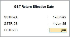

  3. Amend the voucher by providing the Return Effective Date.
    1. In the voucher, press Ctrl+I (More Details).
    2. Under Additional Details, type or select GST Return Effective Date and press Enter.
    3. Enter the Return Effective Date and press Ctrl+A to save.
      If the voucher was originally signed by the counterparty for May-25 and amended in Jun-25, then the Return Effective Date will fall in Jun-25.
    4. Press Ctrl+A to save the voucher.
