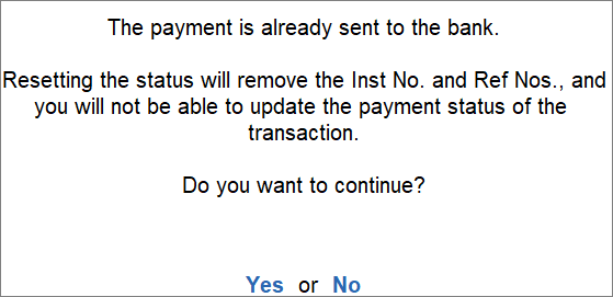

You will need to send or export such payments again. So, you need to reset the status.
  1. Select the transaction and press F8 (Reset Pymt Status).
  2. Press Y to confirm.
The e-Payment transaction will move to the Ready for Sending to Bank section.
If you want to make any changes to the transaction, then you can do so before sending or exporting the payment again.

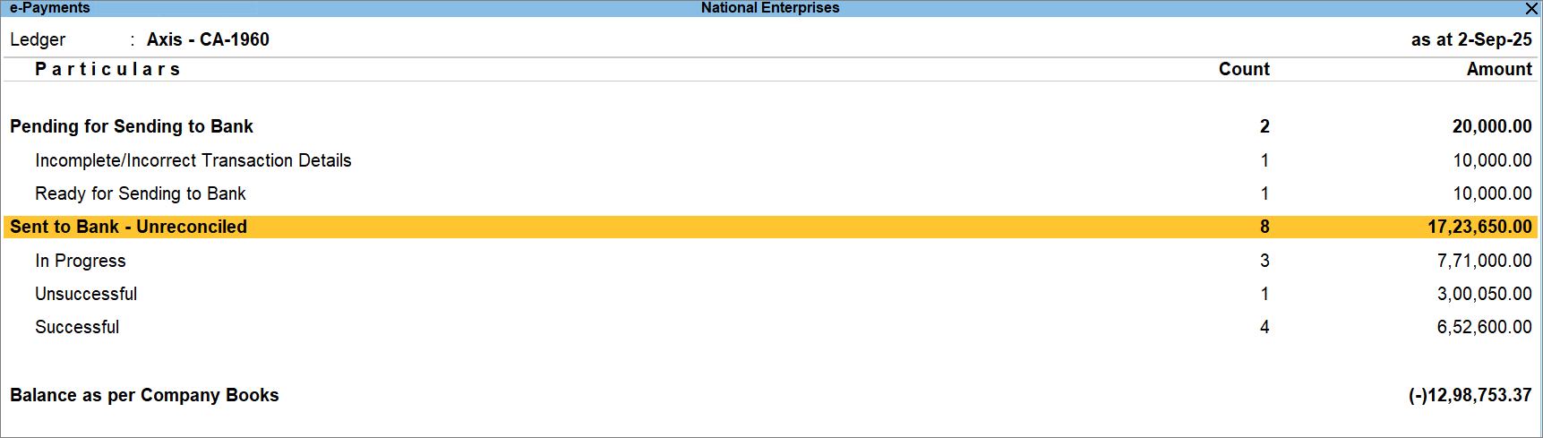

  1. Press Alt+G (Go To) > type or select Banking Activities, press Enter, and then drill down from the e-Payments column for a specific Bank ledger.
  2. In the e-Payments report, drill down from the Sent to Bank (Unreconciled) section.

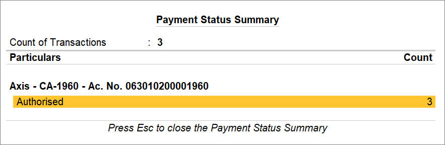

  3. Press F10 (Get Online Payment Status)to get the status of all online payments.
    To get the status of specific online payments, press Spacebar to select the relevant transactions and press F10 (Get Online Payment Status).
    The status is received from the bank, and you can view a Summary.
    You can view the Bank Account along with the number of payments against the specific statuses.
If one or more transactions are rejected either by the approver or the bank, then the status will be Rejected. The payment status can also be Failed due to errors that occurred while sending or processing the payment.
In the Sent to Bank (Unreconciled) section, you can view the error details for the failed or rejected transactions. You can reset the payment status of the failed or rejected transactions. Thereafter, you can alter the transactions, based on the error details, and send them again.
