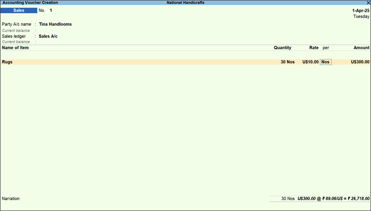

  1. Press Alt+G (Go To) > Create Voucher > press F8 for Sales.
  2. Provide the required details.
  3. After entering item details, enter the Rate of the item in the foreign currency by adding the currency symbol along with the rate.
    If you have already created the Rate of Exchange, the Forex Rate of Exchange screen appears.
    1. Enter the latest Rate of Exchange.
      Set up rate of exchange with foreign currency in TallyPrime
    2. Press Ctrl+A to save the Forex Rate of Exchange screen.
      Sales invoice with foreign currency in TallyPrime
  4. Provide other details, as needed, and press Ctrl+A to save the sales invoice.

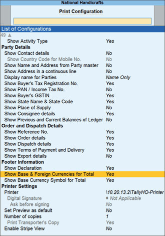

    1. Press F12 (Configure) or press C.
    2. In the Print Configuration screen, locate Show Base & Foreign Currency for Total press Enter to enable it.
      Sales invoice print configuration for foreign currency in TallyPrime
    3. Press Ctrl+A to save the setting.
  4. Press I (Preview) to check the invoice before printing, if needed.
  5. Press P (Print) to print. The print preview of the sales invoice appears.
