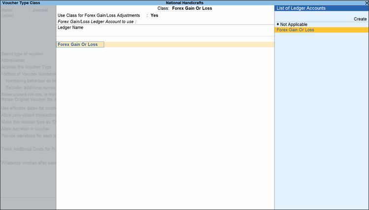

Create Journal Voucher for Forex Gain or Loss
  1. Press Alt+G (Go To) > Alter Master > type or select Voucher Type> select Journal and press Enter.
  2. Specify a Voucher Class name.
    For example, Forex Gain Or Loss.
  3. Use Class for Forex Gain/Loss Adjustments: Yes.
  4. Select Forex Gain Or Loss ledger.
    View forex gain or loss with foreign currency in TallyPrime
  5. Press Ctrl+A to save.

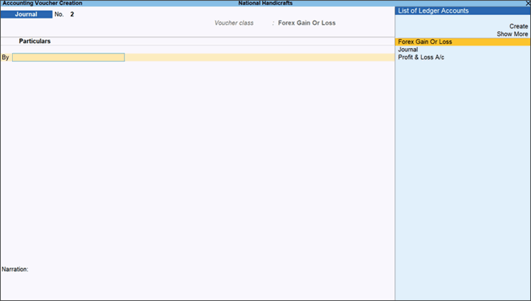

Create Journal Voucher for Forex Gain or Loss Using a Voucher Class
  1. Press Alt+G (Go To) > type or select Create Voucher > press F7 (Journal).
  2. Select the Voucher Class created for forex gain or loss.
    TallyPrime will display all the ledgers created to account for forex gain or loss.
    Create journal voucher for forex gain or loss ledger in TallyPrime
  3. Select the required ledger and enter the amount.
    Journal voucher in foreign currency in TallyPrime
  4. Press Ctrl+A to save.
