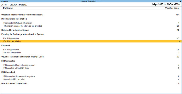

  1. Press Alt+G (Go To) > type or select e-Invoice > press Enter.
    cancel e-Invoice
  2. In the e-Invoice report, drill down from the required section, which can be either Pending for IRN Cancellation, Exported for IRN Cancellation, or Marked as IRN Cancelled.
  3. Press Alt+F5 for more details. You can see details of the cancellation, such as Reason for Cancellation and Remarks.
