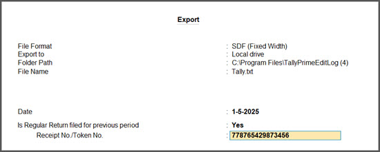

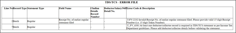

Cause: This error occurs while validating the exported e-Return 26Q file in FVU 9.2 tool, if the previously filled Receipt or Token Number is incorrect/invalid in the exported text file.
Resolution:
Provide a valid 15-digit Receipt Number that starts with 77 and then export the text to ensure successful validation.
  1. Download the previously filed TDS Acknowledgement Receipt from the Income Tax Portal.
    1. Open Income tax portal and log in.
    2. Go to e-File > Income Tax Forms > View Filed Forms.
    3. Select the Form Type as 26Q and click Download Acknowledgement to get the Acknowledgement Receipt of Income Tax Forms in PDF.
      Note: Ensure the e-Filing Acknowledgement Number and RRR Number are unique. If they appear identical, re-download the Acknowledgement Receipt of Income Tax Forms after 10–20 minutes to generate distinct values.
  2. Update the Receipt No./Token No. field.
    1. Press Alt+G (Go To) > Form 26Q > Alt+E (Export) > E-Return.
    2. In the Export screen, fill the Receipt No./Token No. with a valid 15-digit RRR Number starting with 77.
      export-screen
  3. Press Ctrl+A (save) and then E (export) to export the file.
Now, you can validate the e-TDS return text file using the latest FVU tool. It will be validated successfully without any error.

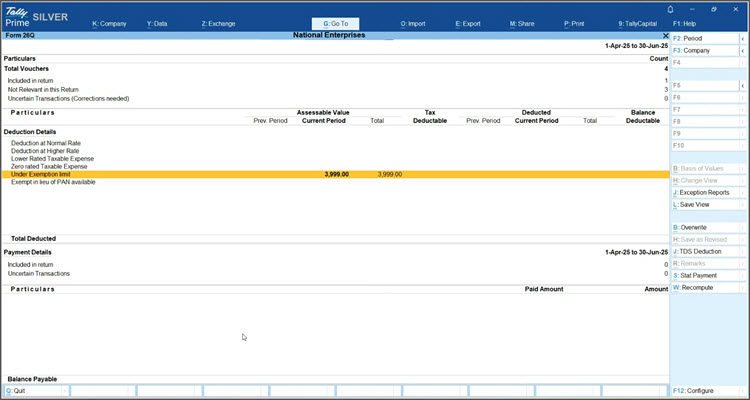

Cause: This error occurs because Remark ‘Y’ is no longer valid for Sections 194B and 194BB in TDS Forms 26Q and 27Q starting from FY 2025–26, as per the latest updates in FVU version 9.2.
This change is due to amendments introduced in the Finance Bill 2025–26. Earlier, the sections 194B – Winnings From Lotteries and Crossword Puzzles and 194BB – Winnings From Horse Race under TDS had an annual limit of Rs 10,000. If exceeded, then TDS was expected to be deducted from Rs 1.
Now, from FY 2025–26 onwards TDS will be deducted only if a single transaction exceeds Rs 10,000.
These changes are updated in latest FVU 9.2 tool version. Therefore, Remark ‘Y’ is no longer valid for the above-mentioned sections.
This error occurs because in TDS Form 26Q and 27Q, Remark ‘Y’ is no longer valid for Section 194B and 194BB from FY 2025–26 onwards, as per FVU 9.2 updates.

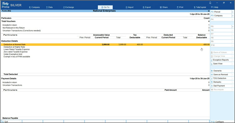

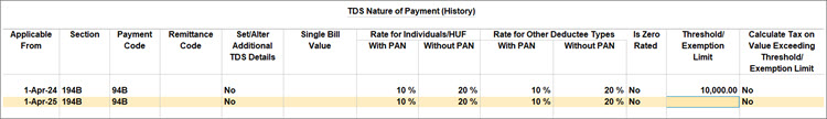

Resolution:
If you have already recorded TDS transaction for Threshold limit below 10000, then in TDS Form 26Q report it participates under Below Exemption Limit section. However, you are now recommended to alter the TDS Nature of Payments and the TDS Nature of Payment (History).
form-26-q
  1. Press Alt+G (Go To) > Alter Master > TDS Nature of Payments > and press Enter.
  2. In the TDS Nature of Payment Alteration screen, press Ctrl+I (More Details) > TDS Details (History) > and press Enter.
  3. In the TDS Nature of Payment (History) screen, create a new history.
    1. Set the Applicable from date as 1-Apr-25.
    2. Leave the Threshold/Exemption Limit field empty and press Ctrl+A to save.
      threshold-limit
      If you have multiple histories, ensure that the Threshold/Exemption Limit is removed only for the history with Applicability date 1-Apr-25.
  4. Recompute TDS Form 26Q report and save as revised.
    1. Press Alt+G (Go To) > Form 26Q.
    2. Press Alt+W (Recompute) and Alt+H (Save as Revised).
    3. Press Yes to continue.
  5. Reopen Form 26Q to view the transaction appearing against the Deduction at Normal rate section instead of the Under Exemption Limit section.

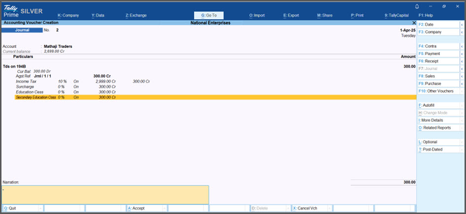

    deduction-at-normal-rate
  6. Pass a Journal Voucher with TDS deduction and save.
  7. Pass a Payment Voucher against the same TDS Journal Voucher and save.
  8. Recompute TDS Form 26Q report, save as revised, and export.

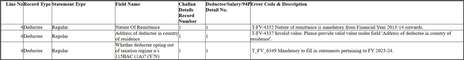

nature-of-remittance
Cause:
This error occurs if the mandatory field Nature Of Remittance is not provided for the transactions below the exemption limit of 20,000.

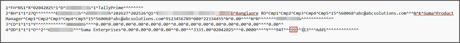

Resolution:
For TDS Section Code 194T-Payments to partners of firms the Payment Code is 94T. This Section is applicable for both Resident (26Q) and Non-Resident (27Q) returns. To report 194T in TDS Form 27Q remittance code is mandatory. However, the new FVU 9.2 tool has not notified any Remittance Code for this section. As per clarification from the Protean/NSDL department, we can use any random code as per Annexure 8 in field number 36 under the DD line of the e-TDS 27Q text file. To avoid the error related to Nature of Remittance, it is recommended that you use 99 as the Remittance Code in that field.
  1. In TallyPrime, export e-return TDS Form 27Q text file.
    1. In TDS Form 27Q report, press Alt+B (Save Return).
    2. Press Alt+E (Export) and select E-Return.
    3. In the Export screen, configure the Folder Path and select Export.
  2. Open the exported e-return TDS Form 27Q and enter the Remittance code as 99 in the field no. 36 of the Deductee Detail Record (DD) line.
    99-field-value
  3. Save the text file.
You can now validate the text file successfully with the latest FVU 9.2 tool and proceed to file TDS 27Q returns.
Cause:
This error occurs if an address is present in the Address of deductee in country of residence field for the transactions below the exemption limit of 20,000.

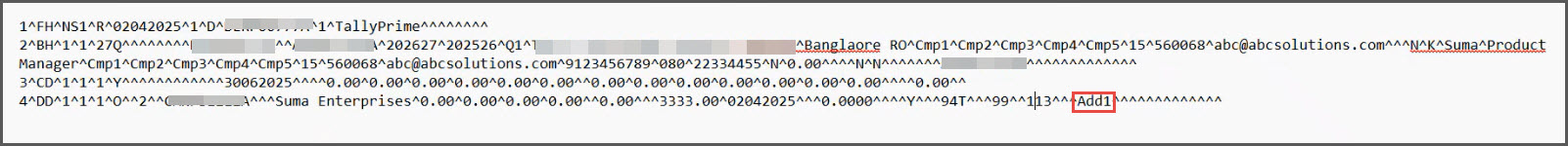

Resolution:
  2. Open the exported e-return TDS Form 27Q and remove the prefilled address in the field no. 41 of the Deductee Detail Record (DD) line.
    address-field-value
Cause:
This error occurs if the field Whether deductee opting out of taxation regime u/s 115BAC (1A) ? (Y/N) is blank for the transactions below the exemption limit of 20,000.

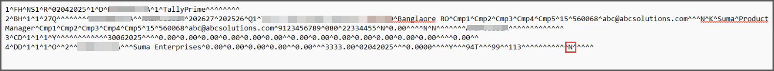

Resolution:
  2. Open the exported e-return TDS Form 27Q and enter N in field no. 49 of the Deductee Detail Record (DD) line.
    field-no-49-value
