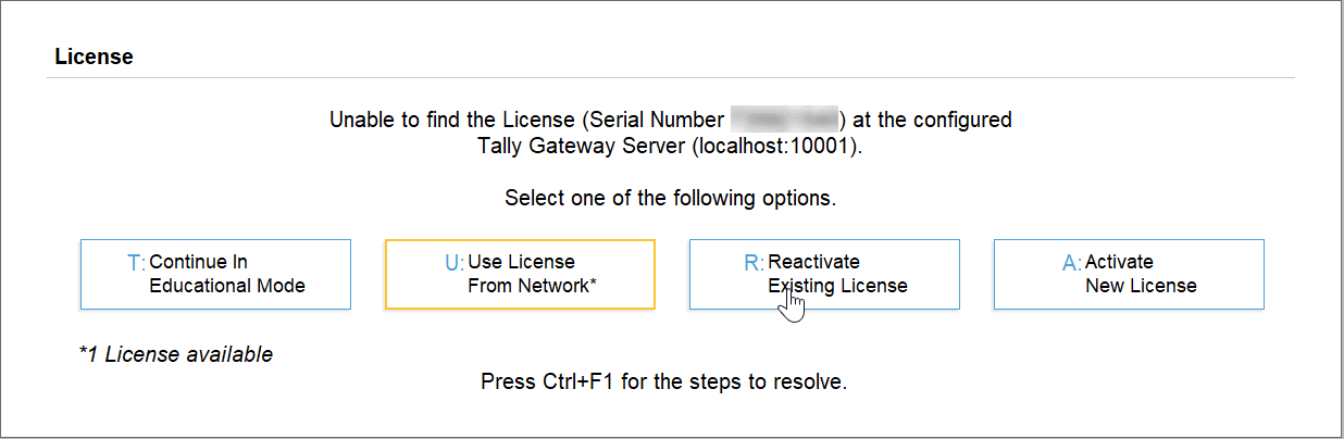

  1. Start TallyPrime Server.
  2. Press (Activate New License) in the License screen.
    activate TallyPrime Server License
    If you don’t view the License screen, you can do one of the following.
    – Press F1 (Help) > Settings > License > Manage License > press F6 (Activate).
    – Click the EDU icon on the top left corner.
  3. Enter the Serial Number and Activation Key.
  4. Enter the E-mail ID/Tally.NET ID
  5. Press Enter to save.
  6. Press C (Create New Site) to activate this site license. The Unlock License screen appears on successful activation.
  7. Enter the Unlock Key sent to your e-mail ID in the Unlock License screen.
  8. Press Enter to unlock your license.

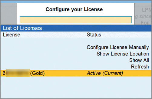

Use License from Network
After activating your TallyPrime server license, if you are installing TallyPrime Server Monitor or TallyPrime Server on a different system, you need to use license from network.
  2. Press U (Use License From Network) in the License screen.
    Alternatively, press F1 (Help) > Settings > License > Manage License, to get the Manage License screen. You can also reach the Manage License screen, by clicking the EDU icon on the top left corner, just below the TallyPrime Server icon.
    Press F4 (Use License From Network).
  3. Select the relevant license, and press Enter to configure the license.
    A message will appear to restart TallyPrime Server. Press Enter to apply the changes.

Reactivate License
Reactivation of the TallyPrime Server license can be performed directly, either on the same computer or on a different system. If you are on a different computer, install TallyPrime Server
  2. Press R (Reactivate Existing License) in the License screen.
    reactivate tallyprime server license
  3. Enter the Tally.NET ID and  Password.
    reactivate license login net id and password
  4. Press Enter to reactivate.
    select the license to reactivate
  5. Select the license you want to reactivate, and press Enter. The following confirmation message appears once your license is reactivated.
