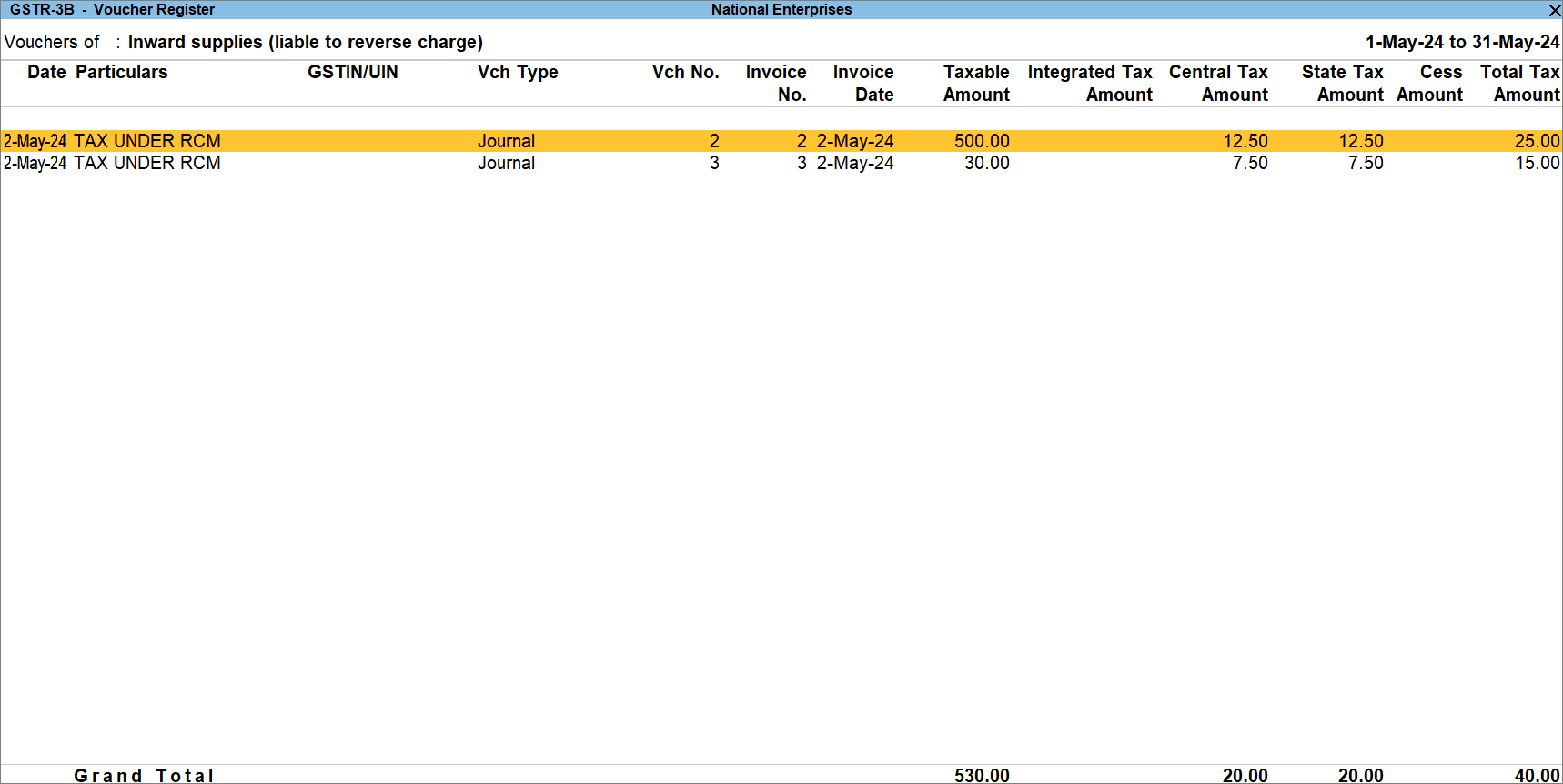

  1. Press Alt+G (Go To) > type or select GSTR-3B and press Enter.
    GSTR-3B - Voucher Register in TallyPrime
  2. Drill down from Inward Supplies (liable to reverse charge).

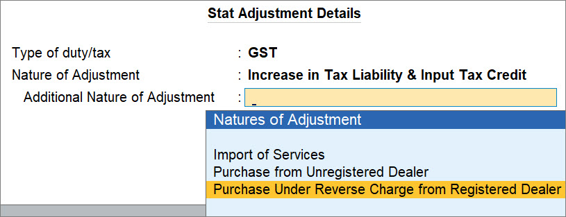

    1. Press Alt+J (Stat Adjustment).
    2. Type of duty/tax: GST.
    3. Nature of Adjustment: Increase in Tax Liability & Input Tax Credit.
      If you want to claim ITC in the subsequent month, then select Increase in Tax Liability. Thereafter, you will need to create a journal voucher in the subsequent month with Nature of Adjustment as Increase in Input Tax Credit.
    4. Additional Nature of Adjustment: Purchase Under Reverse Charge from Registered Dealer.
      If the dealer is unregistered, then select Purchase from Unregistered Dealer.
      Stat Adjustment Details in TallyPrime

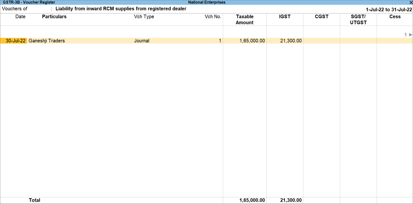

        Once you record the journal voucher to raise the tax liability for the purchase of RCM goods in TallyPrime, the transaction gets included in the return and starts appearing in GSTR-3B as Liability from inward RCM supplies from registered dealer.
        Liability from Inward RCM Supplies from Registered Dealer in TallyPrime

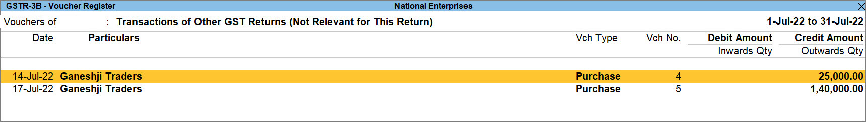

As a result, the sample purchase vouchers against which the tax liability was raised to claimed ITC will move to the Not Relevant for This Return section of GSTR-3B.

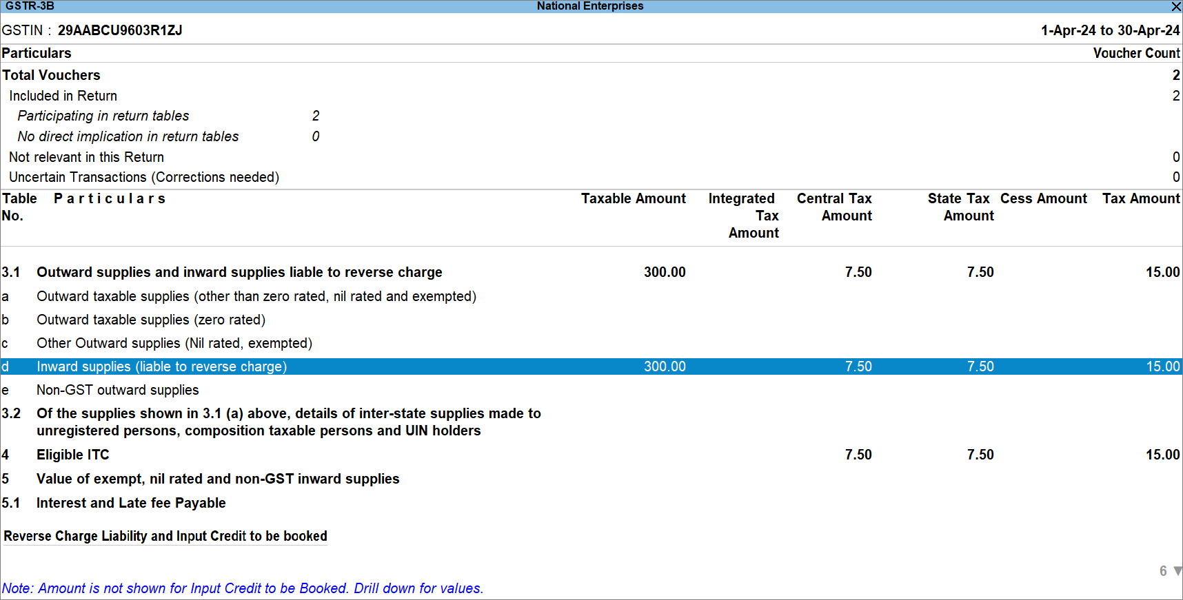

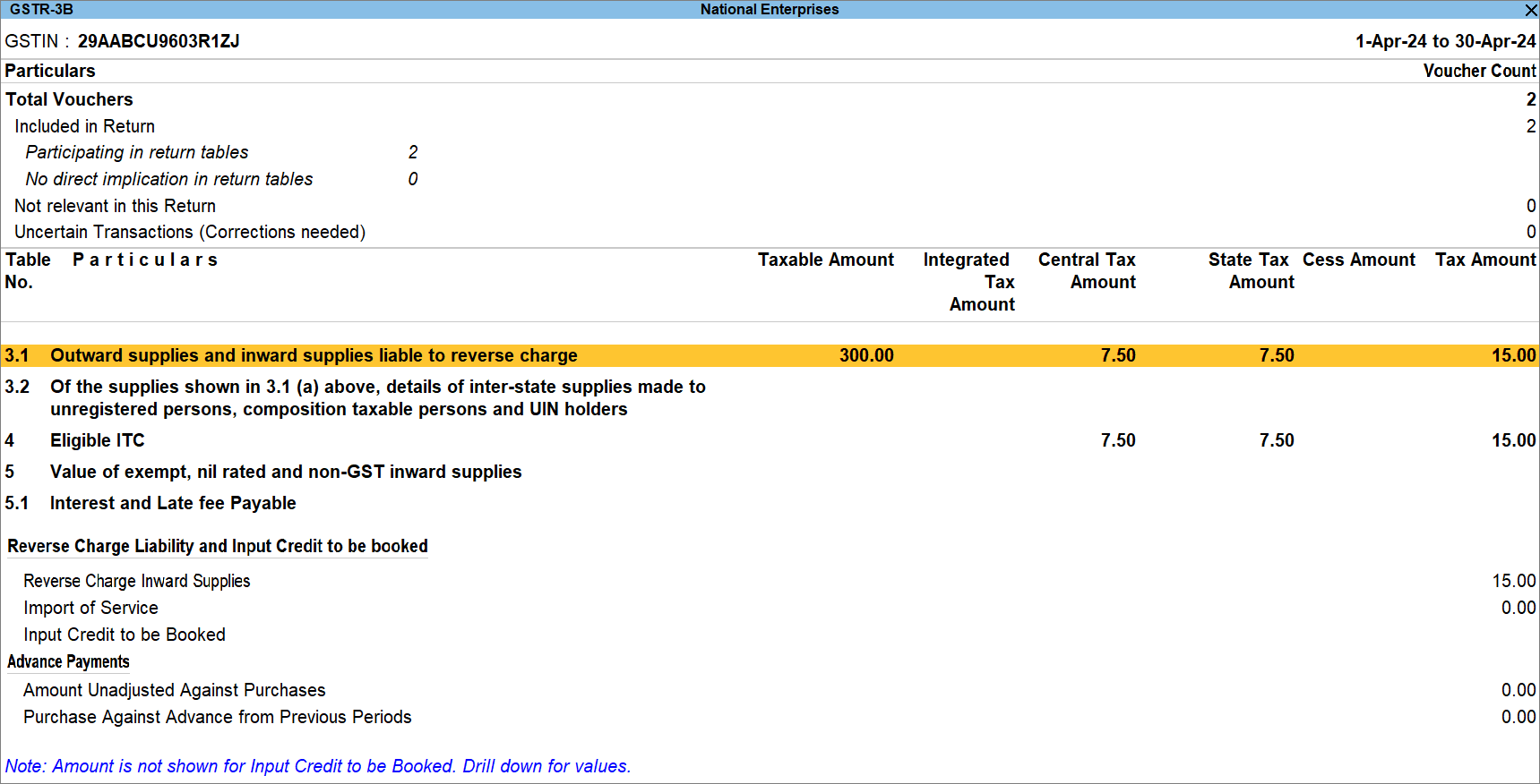

  1. Press Alt+G (Go) > type or select GSTR-3B, and press Enter.
    GSTR-3B in TallyPrime
  2. Press Enter on Outward supplies and Inward supplies liable to reverse charge.
    Outward and Inward Supplies Liable to Reverse Charge in TallyPrime

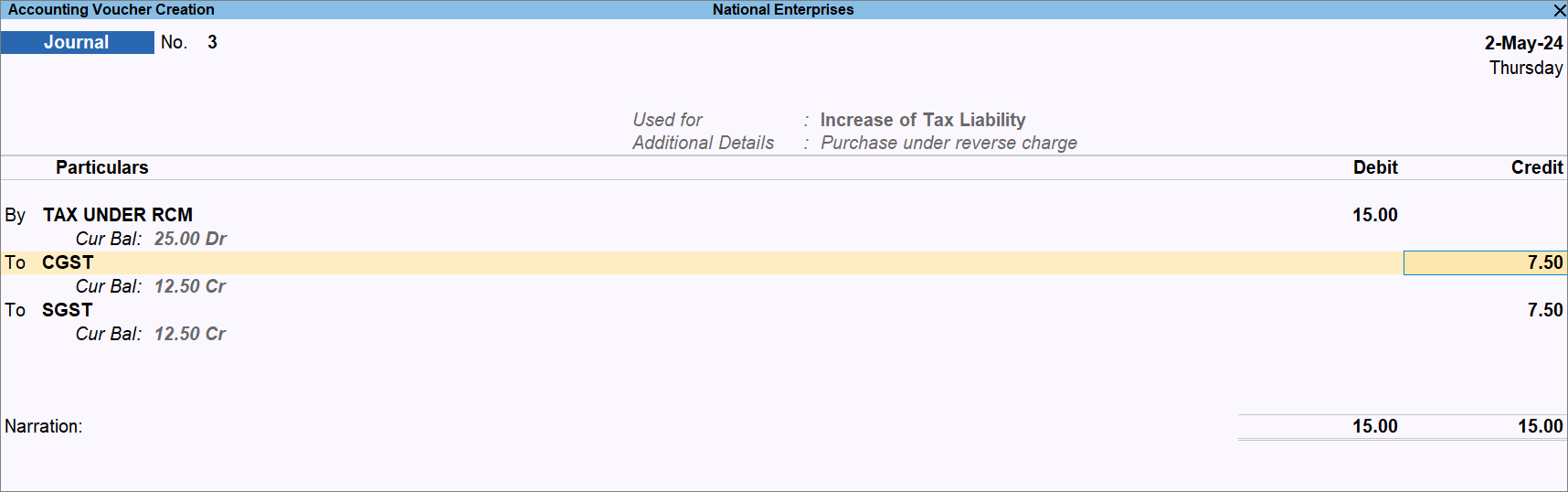

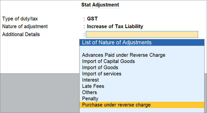

  3. Press Alt+J (Stat Adjustments) and provide the relevant details in the Stat Adjustment screen.
    1. Nature of Adjustment: Increase of Tax Liability.
    2. Additional Details: Purchase under reverse charge.
      A Journal Voucher screen appears.
  4. Create the Journal Voucher to raise the liability.
    1. Under By, Select the relevant ledger created for Liability and enter the amount.
    2. Provide the tax ledger details.
      1. Under To, Select the relevant GST ledger.
      2. Enter the tax rate and the invoice amount.
        The tax amount gets calculated.
        Enter another GST ledger, if it is an intrastate transaction.
    3. Press Ctrl+A to save the voucher.
      Journal Voucher to Raise Liability in TallyPrime

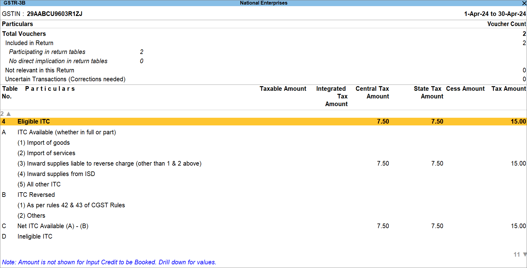

  2. Press Enter on Eligible ITC.
    GSTR-3B - Eligible ITC in TallyPrime

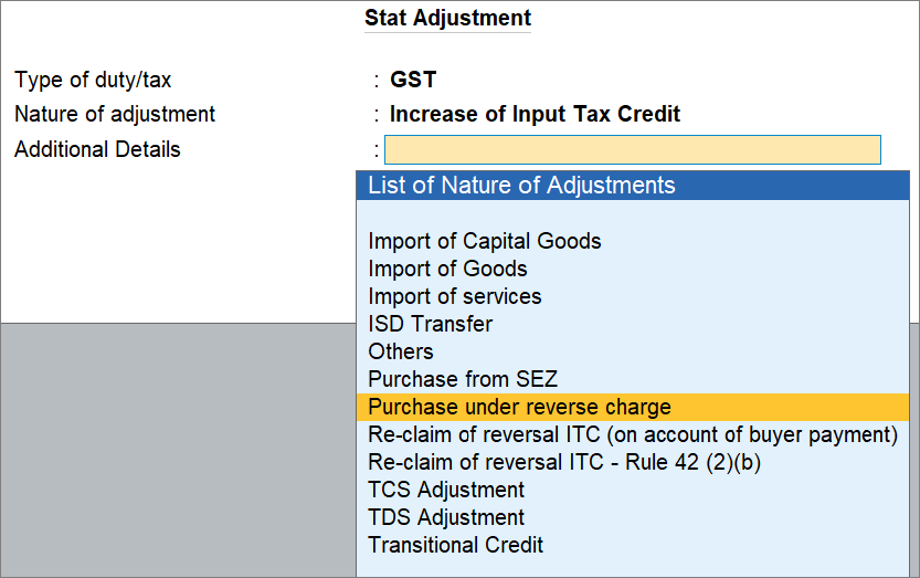

    1. Nature of Adjustment: Increase of Input Tax Credit.

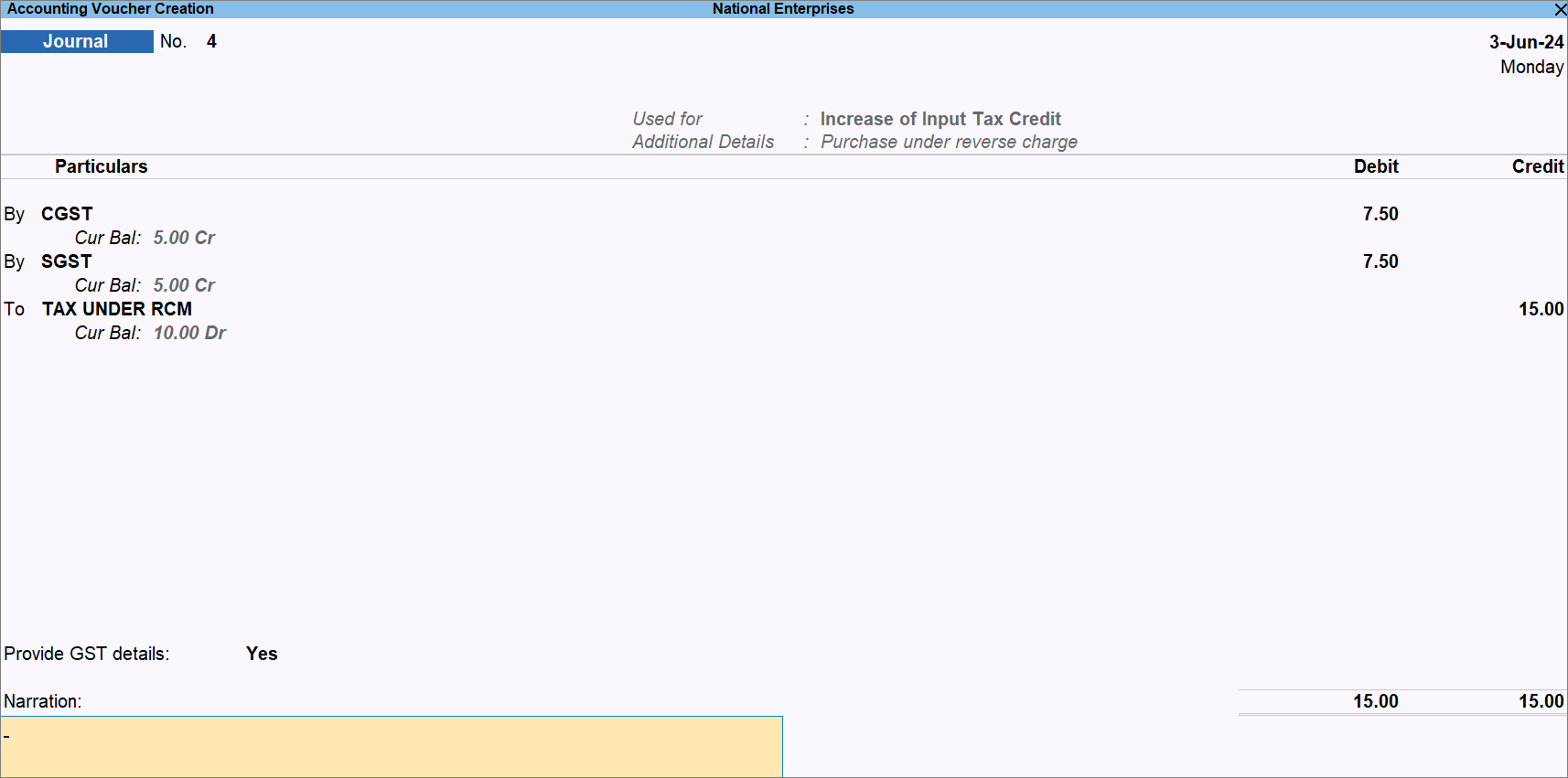

    1. Press F2 (Date) and enter the date of the subsequent period in which you are claiming the ITC.
      1. Under By, select the relevant GST ledger.
      3. Under To, Select the relevant ledger created for Liability and enter the amount.
      4. Specify the tax period.
        1. Provide GST details: Yes.
        2. Enter the Period From and To dates.

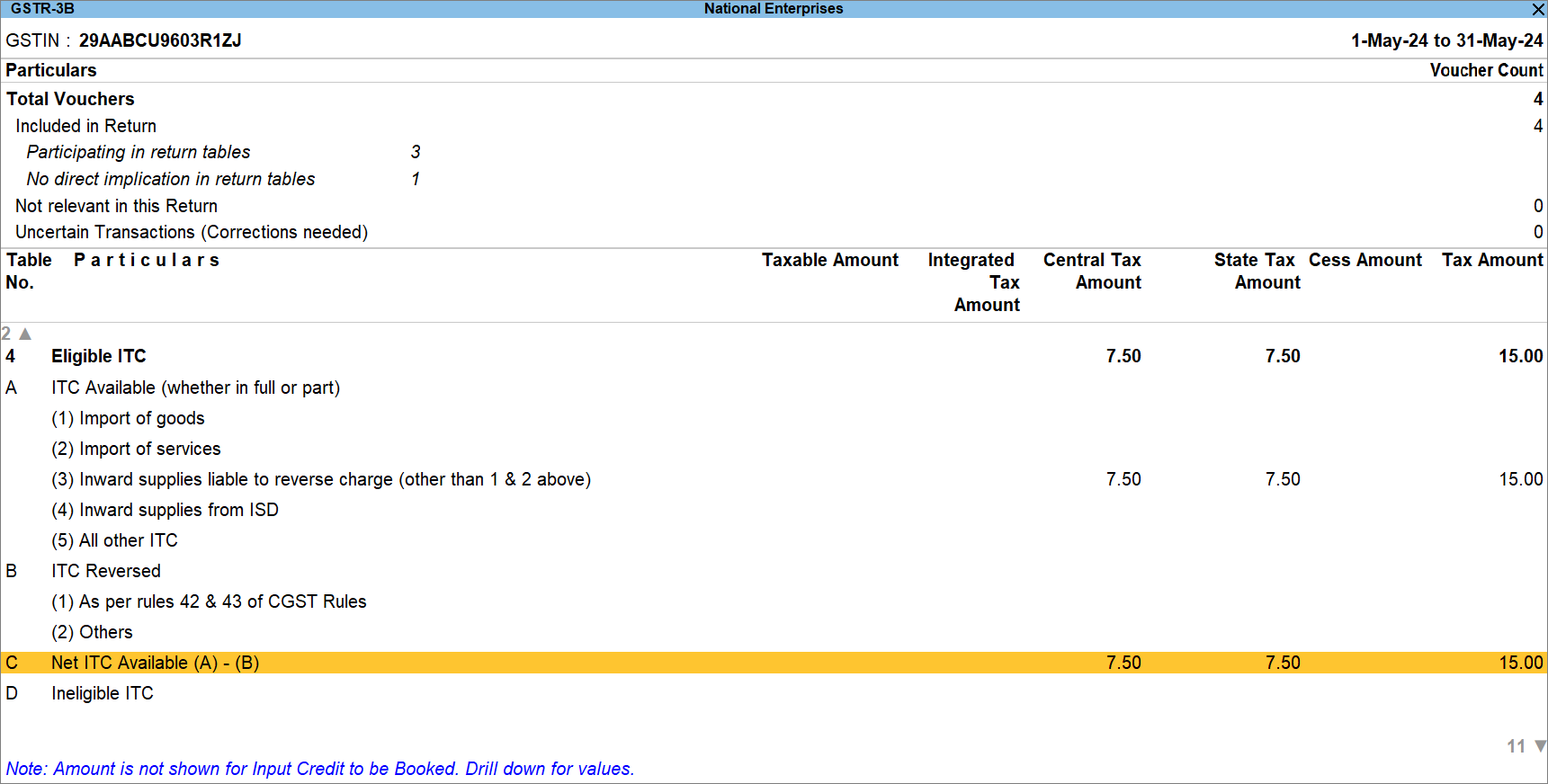

      5. Press Ctrl+A to save the voucher.
        Journal Voucher to Claim ITC in TallyPrime
In GSTR-3B, you can view that the Net ITC Available (A) – (B):
