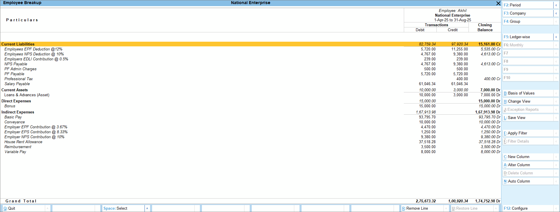

This report displays a group wise summary of the transactions and Closing balance for the selected Employee. Drill down to specific ledger of the group, to the month wise summary and up to voucher, is available in this report.
  1. Gateway of Tally > Display More Reports > Payroll Reports > Employee Pay Head Breakup.
    Alternatively, press Alt+G (Go To) > type or select > Employee Pay Head Breakup and press Enter.
  2. Select the Employee from the list, to view the Pay Head Breakup for that employee.
    Note: Press F12 (Configure) for additional options in the above report.
  3. You can drill down to Breakup of Employee for each Group, from this report.
  4. Drill down further to view the Ledger Monthly Summary report and the Employee Vouchers.
