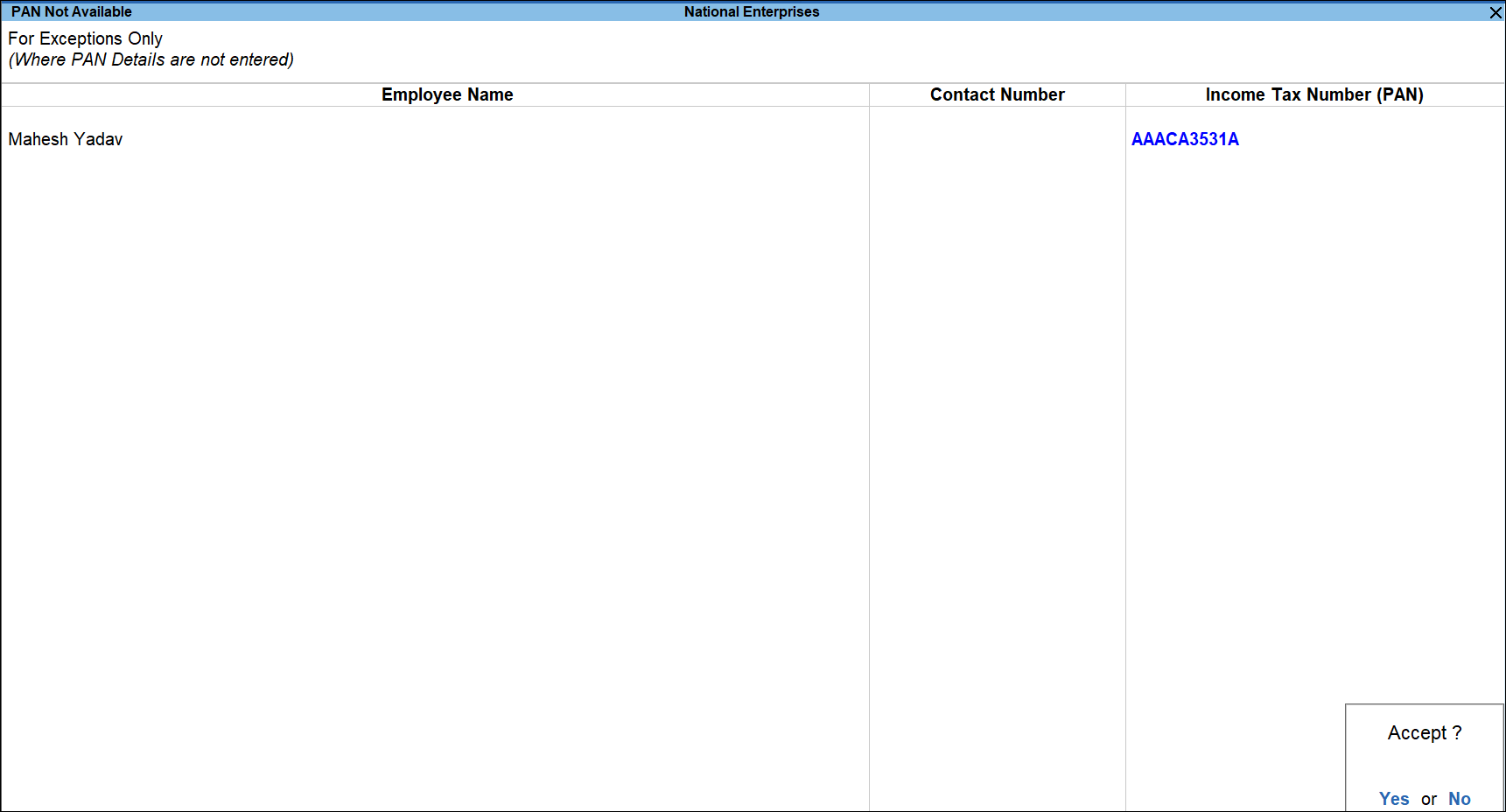

For computing tax correctly, its necessary that you specify the PAN number for all the employees. The tax will be computed at higher rate if the PAN number for the employee is not provided. You can check the information of employees for whom the PAN is not provided from PAN Not Available screen.
  1. Press Alt+G (Go To) > type or select Employees Without PAN.
    The above report displays the employees for whom the PAN is not specified in the employee master.
  2. Specify the PAN for all such employees in the Income Tax Number (PAN) field.
    pan-not-available-report
