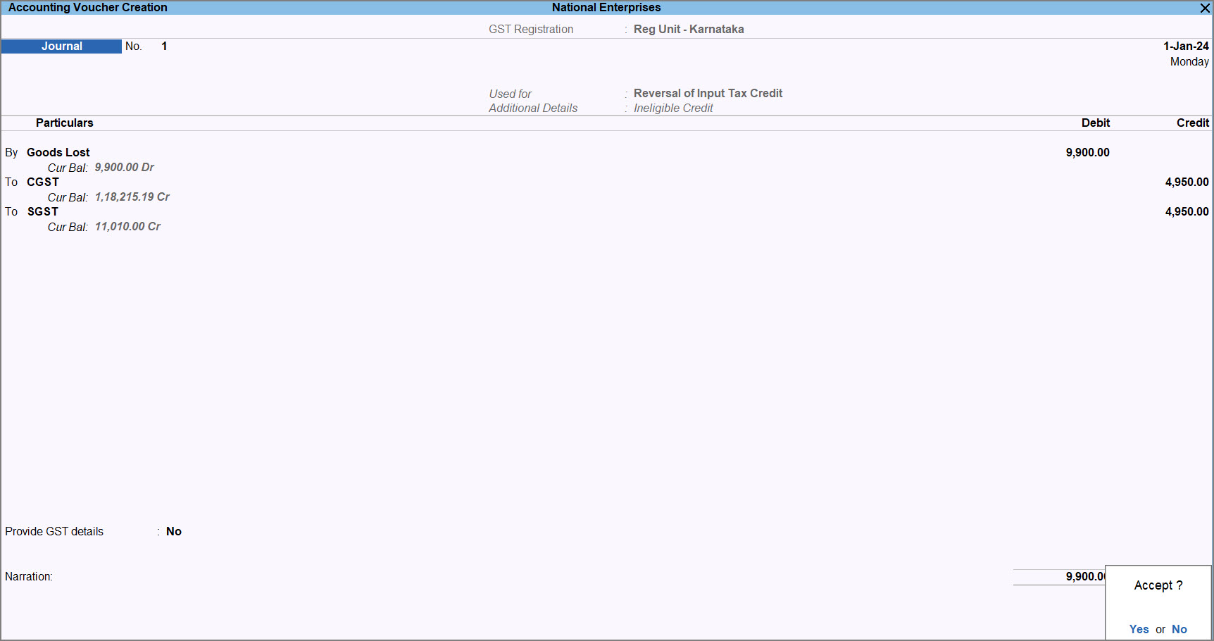

In the above purchase, if one computer is lost in transit, then the tax credit on that becomes ineligible, and needs to be reversed. You can reverse the tax credit using journal voucher.
  1. Press Alt+G (Go To) > Create Voucher > press F7 (Journal).
  2. Press Alt+J (Stat Adjustment).
  3. In the Stat Adjustment Details screen, select the options as shown below:
  4. Debit the expense ledger and credit the tax ledgers.
    journal
  5. Accept the screen. As always, you can press Ctrl+A to save.

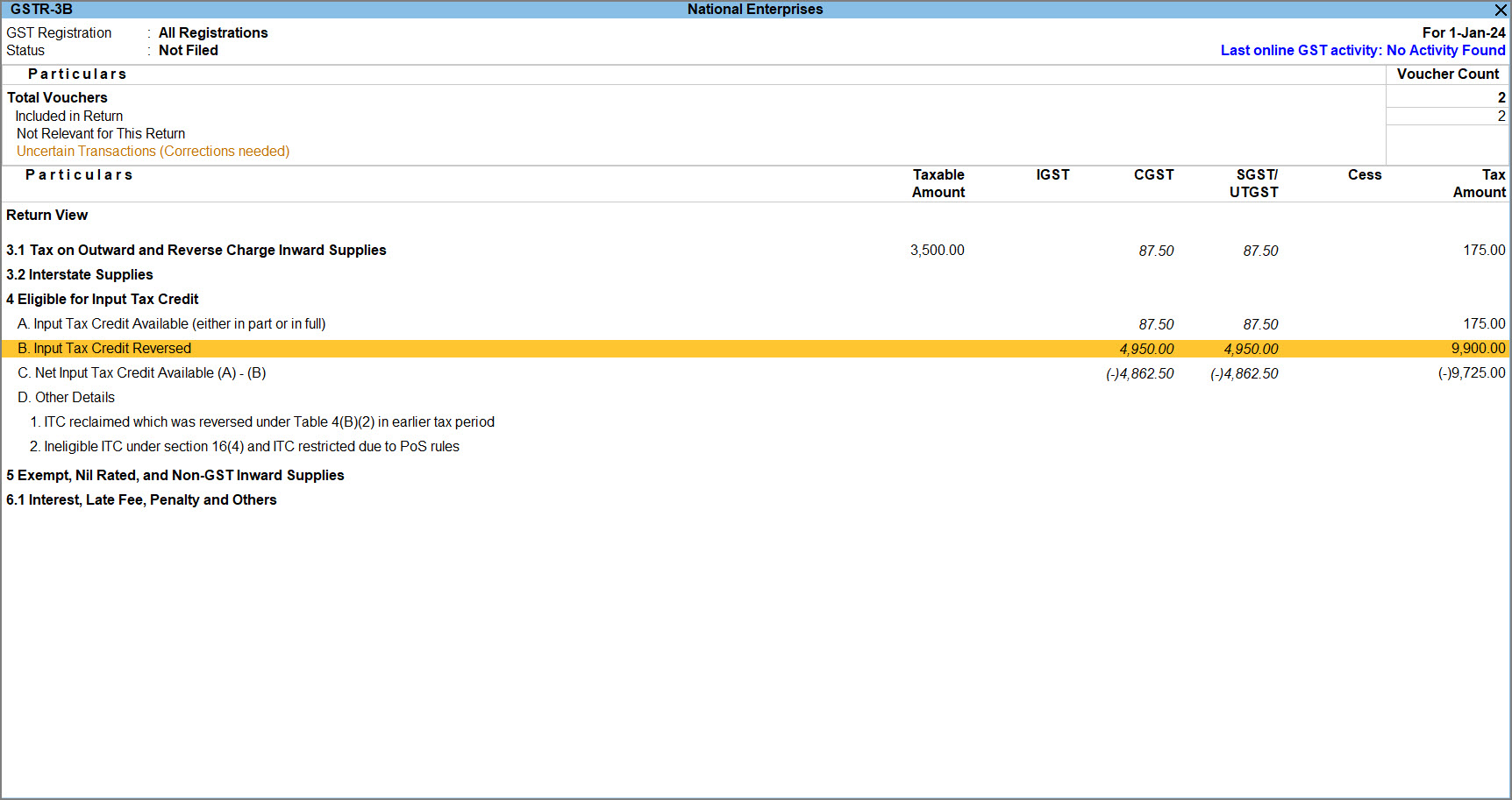

    The amount reversed as ineligible tax credit appears in detailed mode, in table 4B of GSTR-3B as shown below:
    gstr-3b
