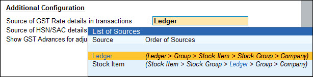

Choose the source of GST details in transactions
What’s more, TallyPrime allows you to set the preferred source from which GST details should be picked up during transaction recording.
GST information can be defined at different levels — Ledger, Group, Stock Item, Stock Group, or Company. Depending on your business type and configuration, you can tell TallyPrime which source to prioritise for HSN/SAC and tax rate while recording transactions.
For example, you run a business where groups of stock items share a common tax rate, but each item or group has a unique HSN/SAC.
In such a case, it is practical to define the tax rate at the group level, and the HSN/SAC at the item level.
To ensure GST details are fetched correctly in transactions, you can configure:
  • Tax Rate Source as Ledger
  • HSN/SAC Source as Stock Item
  1. Press F11 > and enable the option Set/Alter Company GST Rate and Other Details > Set Source of GST Details in Transactions.
  2. Press F12 (Configure) > and enable the options Set Source of GST details in transactions and Set Source of HSN/SAC details in transactions.
  3. Select the Source from the List of Sources.
GST Rate Details in TallyPrime
If a GST detail is not found at the selected source, TallyPrime automatically moves up the relevant hierarchy until it finds the value.
Hierarchy for Tax Rate
Ledger > Ledger Group > Stock Item > Stock Group > Company
Hierarchy for HSN/SAC
Stock Item > Stock Group > Ledger > Ledger Group > Company
This ensures that even if you miss configuring GST details at the selected source, TallyPrime will still attempt to pick up correct values from the next level in the chain.

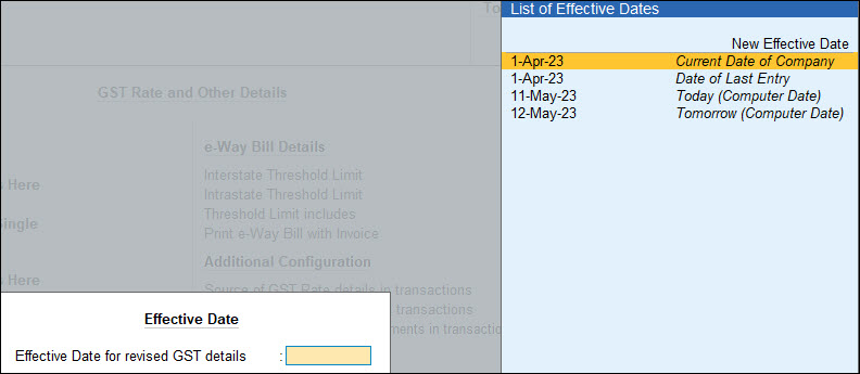

Effective Date for Changes to GST Details in Masters
There are situations when you will need to update the GST details in your masters and those updates may have an impact on your vouchers and returns overall. We also understand that you may want such changes to take effect from a specific date onwards, and therefore TallyPrime prompts you to enter the effective date when you alter the GST details in masters, including at the company level.
Enter the Effective Date and you are all set. TallyPrime will track of the date you specify and ensure that those changes are effective from that date.

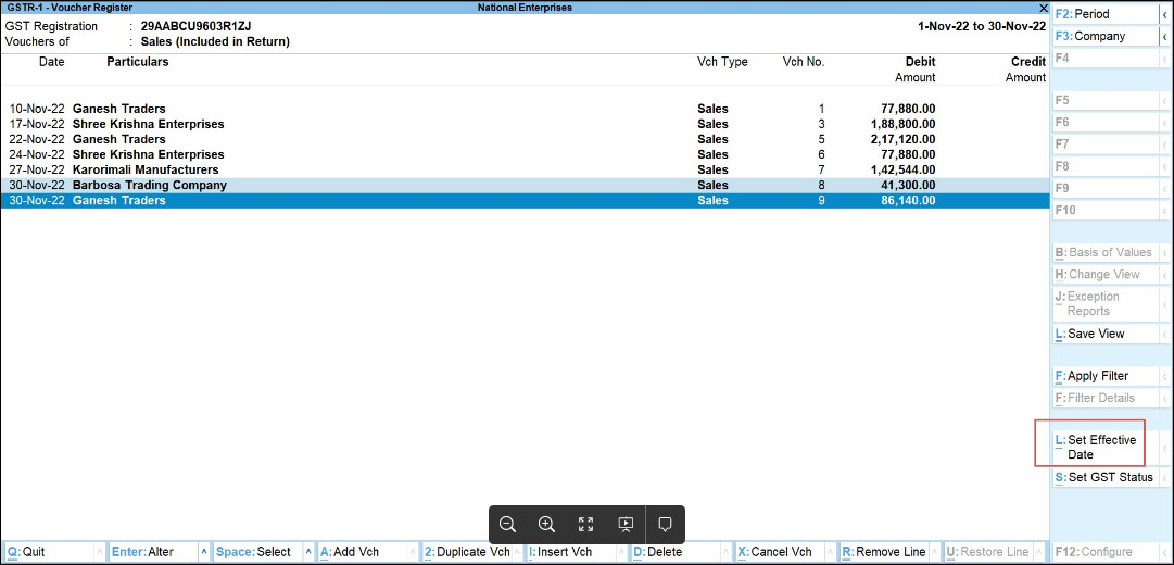

Specify GST Return Effective Date for Multiple Vouchers
There are situations in which you will need to include multiple transactions in a different Return period. In such a case, you can set Return Effective Date for multiple vouchers in TallyPrime.
This facility is especially useful when:
  • There are multiple vouchers to move to a subsequent Return period.
  • There are multiple vouchers in which you had made changes for amendment.
    However, you did not specify the Return Effective Date at the time of making the changes, and therefore, the vouchers have moved to the Uncertain Transactions (Corrections needed) section of the respective GST Return report.
  1. Press Alt+G (Go To) > type or select the GST Return such as GSTR-1 or GSTR-3B, as applicable, and press Enter.
  2. Drill down to the section that contains the vouchers in which you need to specify Return Effective Date.
  3. Press Spacebar to select multiple vouchers.
    Or press Ctrl+Spacebar to select all the vouchers.
  4. Specify the Return Effective Date for the selected vouchers.
    1. Press Alt+L (Set Effective Date).
    2. Enter the date and press Ctrl+A to save.
As a result, the vouchers will start appearing in the Return period, based on the date entered in the GST Return Effective Date screen.

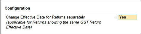

Specify Different GST Return Effective Date for GSTR-1 and GSTR-3B
You may want a specific voucher to appear in GSTR-1 of a specific Return period, while it should appear in a different Return period of GSTR-3B. You can provide different Effective Dates for GSTR-1 and GSTR-3B.
Consider that you filed GSTR-3B and later realised that one of the vouchers was missing.
In such cases, you record the invoice and report it in GSTR-1 in the same period, while you can report the corresponding voucher in GSTR-3B of the subsequent period.
  1. In the Accounting Voucher Alteration screen, press Ctrl+I (More Details) > type GST Return Effective Date and press Enter.
    The GST Return Effective Date screen appears.
  2. Change the Effective Date for Returns separately.
    1. Press F12 (Configure), set Change Effective Date for Returns separately to Yes, and press Ctrl+A to save.
    2. Enter the dates as per the Return periods of GSTR-1 and GSTR-3B, applicable to the voucher.
    3. As always, press Ctrl+A to save the voucher.

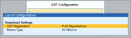

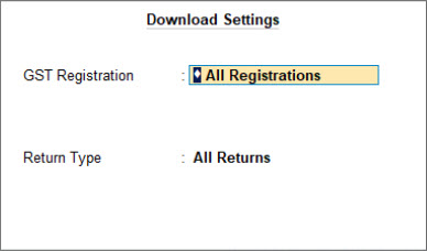

Configure Default Return Types for Download
For TallyPrime 5.0 & later
You can specify the default return type for download, so whenever you start downloading GST returns, that return type will be selected automatically. You can switch to a different return type anytime.
  1. Press Alt+Z (Exchange) > Configure.
    Configuration for GST Return Type for Downloading
  2. GST Return Type for Download: Select the required Return Type, such as GSTR-3B.
    You also have the flexibility to select All Returns.
    Configuration for Downloading GST Returns in TallyPrime
  3. Press Ctrl+A to save the configuration.
    The selected Return Type or All Returns will be considered as the default in subsequent downloads.
