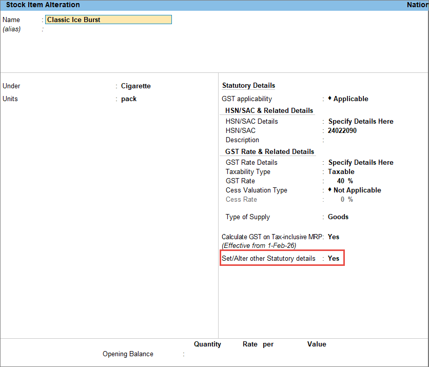

One-time Setup of Stock Item Master
  1. Update the GST details in the Stock Item.
  2. Update the Excise details in the Stock Item.
    Stock-Item-Alteration
    1. In the Stock Item Alteration screen, enable Set/Alter other Statutory details.
    2. In the Tax Details screen:
      Tariff-details
      1. Set Is Excise Applicable to Applicable.
      2. Set Set/alter excise details to Yes.

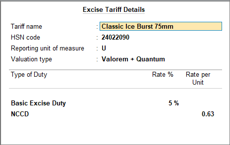

        • In the Excise Tariff Details screen, enter the following:
          Excise-Tariff-Details
          1. Tariff name: Enter the name as applicable.
          2. HSN code: Enter the 8-digit HSN code.
          3. Reporting unit of measure: Select the Reporting unit of measure as applicable.
          4. Valuation type: Select Valorem + Quantum from the List of Valuation Types.
          5. Enter the Rate% for Basic Excise Duty and the Rate per Unit for NCCD based on the cigarette length and Conversion Factor.
          6. In the Tariff Details Applicability screen, update Applicable From as 1st Feb, 2026.
      3. Type of stock item: Select Finished Goods from the list of Natures of Stock Item.
      4. Conversion Factor: Enter the number of units per pack applicable to the respective stock item. For example, 1 pack = 10 units.

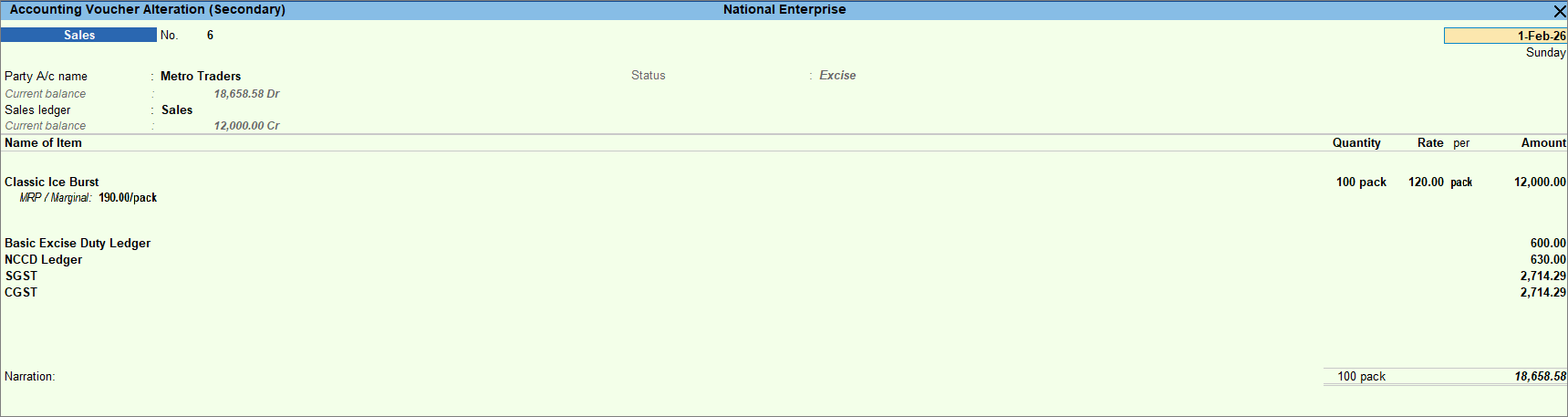

Record the Sales Transaction
  1. In the sales voucher, enter the stock item, quantity, and rate of sale.
    Sales-Transaction
  2. Select the Excise tax ledgers.
    • Basic Excise Duty Ledger
    • NCCD Ledger
      The tax amount appears as per the rates configured in the Stock Item.
  3. Select the appropriate GST tax ledger.
  4. Press Ctrl+O (Related Reports) to view the below Tax Analysis report.
    1. GST – Tax Analysis: to view the GST tax breakup.
    2. Excise – Tax Analysis: to view the Excise tax breakup.
  5. Press Ctrl+A to save the voucher.
