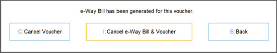

  • Open the voucher in alteration mode and press Alt+X (Cancel).
You will come across one of the two scenarios:
Scenario 1: The 24-hours time limit has not exceeded for e-Way Bill or the e-Way Bill has no Part B details.
ewbgenerated

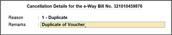

  1. Press I (Cancel e-Way Bill & Voucher) to cancel the e-Way Bill on the portal and cancel the voucher in the Company Book.
  2. Fill the Cancellation Details of e-Way Bill.
  3. Press Ctrl+A to save the cancellation details.

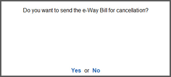

    A message appears asking confirmation to send details for cancellation.
    ewb-cancel-confirm
  4. Press Y to exchange the e-Way Bill cancellation details with the portal.
You will see a confirmation message indicating that the e-Way Bill has been cancelled successfully.

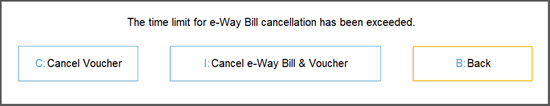

Scenario 1: The 24-hours time limit has exceeded for e-Way Bill.
If you have e-Way Bill with Part B details, a message appears indicating that the time limit for cancellation has exceeded.
ewb-cancel-after-24h
  • Press B (Back) to return to the Voucher alteration screen without proceeding further.
  • Press C to cancel the voucher in TallyPrime. However, you are not recommended to do so, as this will only cancel the voucher in TallyPrime and will not impact the e-Way Bill.

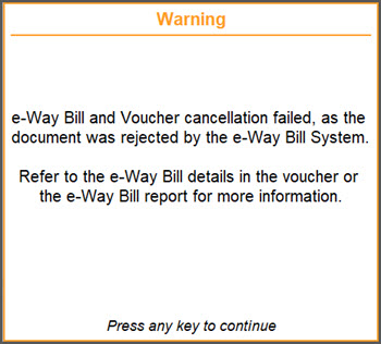

  • If you press I (Cancel e-Way Bill & Voucher), you will see the message about rejection of cancellation of e-Way Bill by the portal and failure to cancel the voucher.

  1. Press I (Cancel e-Way Bill & Voucher) to cancel the e-Way Bill on the portal and delete the voucher in the Company Book.
    ewb-cancel-confirm

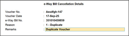

  2. Press Ctrl+ I (More Details)> Show More > e-Way Bill Cancellation Details.
  3. Fill in the e-Way Bill Cancellation Details and save.
    ewb-cancel-details
  4. Press Ctrl+A to save the cancellation details for e-Way Bill in the voucher.

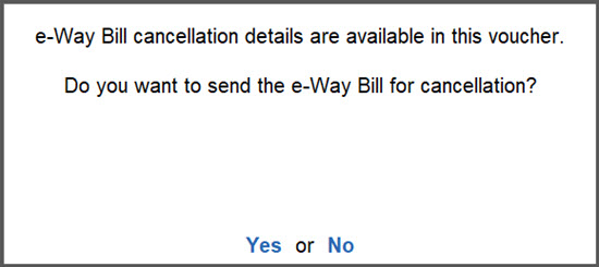

You will see a message that the invoice has the cancellation details.
ewb-with-cancel-details
  • Press Y to send the cancellation Details of e-Way Bill to the portal.
    If you press N, the cancellation details will be saved.
You can see these vouchers appearing under the section For EWB Cancellation of the e-Way Bill report. From there, you can send such e-Way Bills for cancellation.
If the e-Way Bill is not cancelled and you reopen the same voucher later, a message will appear when you try to save it. This message will confirm that cancellation details are available for the e-Way Bill and ask whether you want to proceed with sending them for cancellation.

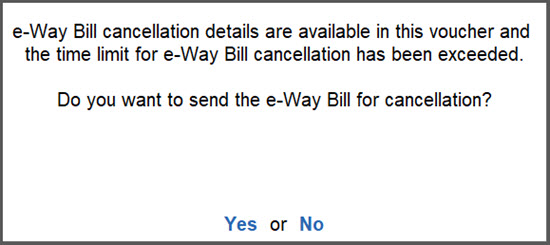

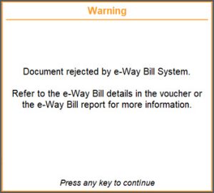

If you have e-Way Bill with Part B details, you will see a message with the information that the invoice has the cancellation details but the allowed time limit has crossed.
ewb-cancellation-24-h-exceeded
If you attempt to cancel by selecting Yes the cancellation request will be rejected by the e-Way Bill portal without impacting the vouchers in TallyPrime.
doc-rejected-by-ewb-portal
