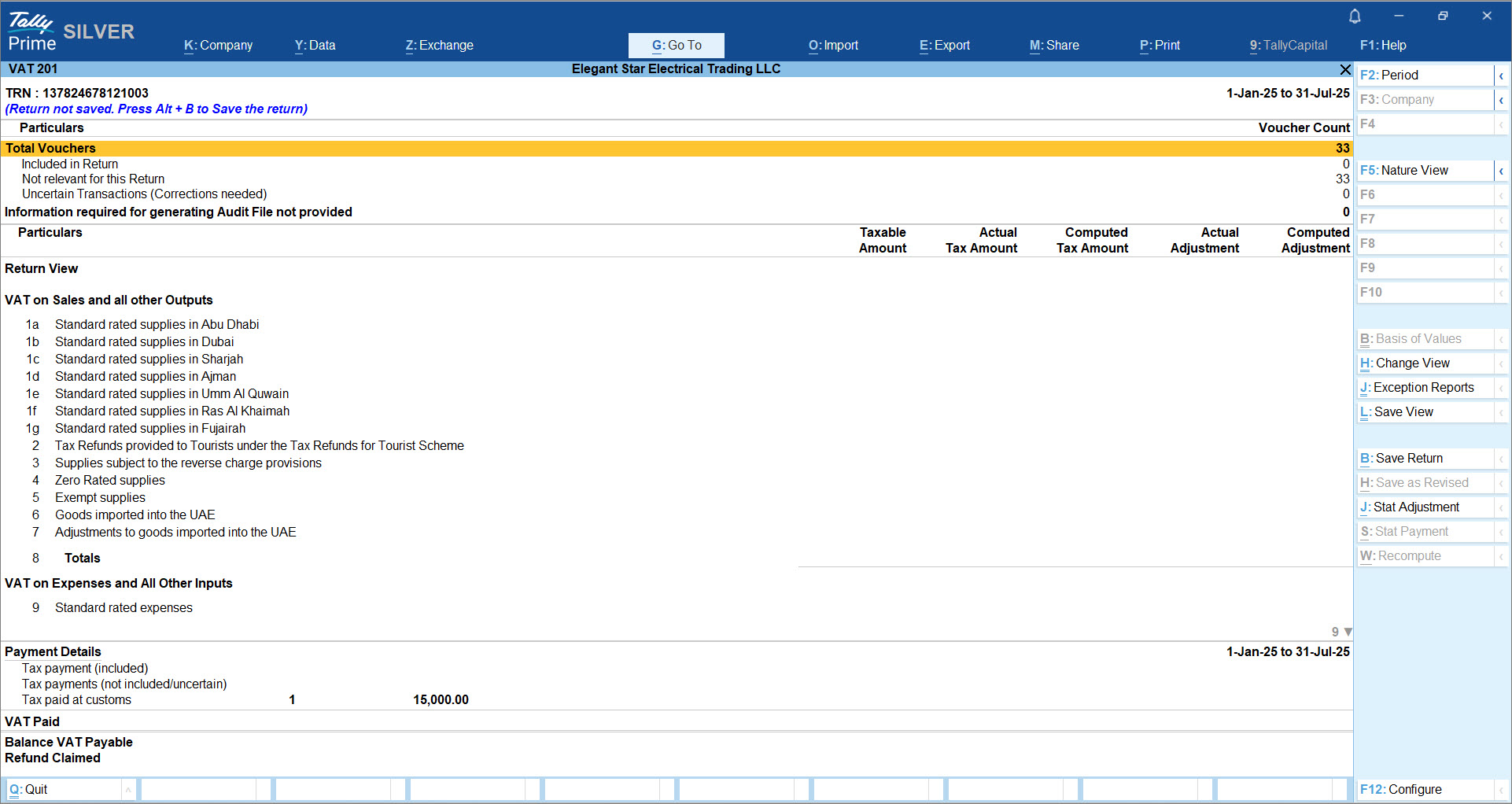

To open the report:
  1. Press Alt + G (Go To) > type or select VAT 201 – Return View.
    The VAT 201 report opens in the Return View by default, showing all details in the same structure as prescribed by the FTA.
    return-view
    The report in the Return View is organised into clear sections:
    • VAT on Sales and All Other Outputs – Displays supplies across Emirates, zero-rated and exempt supplies, reverse charge transactions, and adjustments.
    • VAT on Expenses and All Other Inputs – Displays inward supplies such as standard-rated expenses and reverse charge supplies.
    • Net VAT Due – Summarises the VAT payable or refundable after adjusting recoverable tax, carried forward credits, or refunds.
    • Payment Details & VAT Paid – Displays tax already paid, uncertain or pending payments, and customs-related tax.
      Each line in these sections displays important values across columns such as:
    • Taxable Amount – Value of supplies/purchases on which VAT is calculated.
    • Actual Tax Amount – VAT recorded in vouchers.
    • Computed Tax Amount – VAT auto-calculated based on specified tax rate by TallyPrime.
    • Actual Adjustment – Manual adjustments entered.
    • Computed Adjustment – Adjustments calculated automatically based on specified tax rate.
