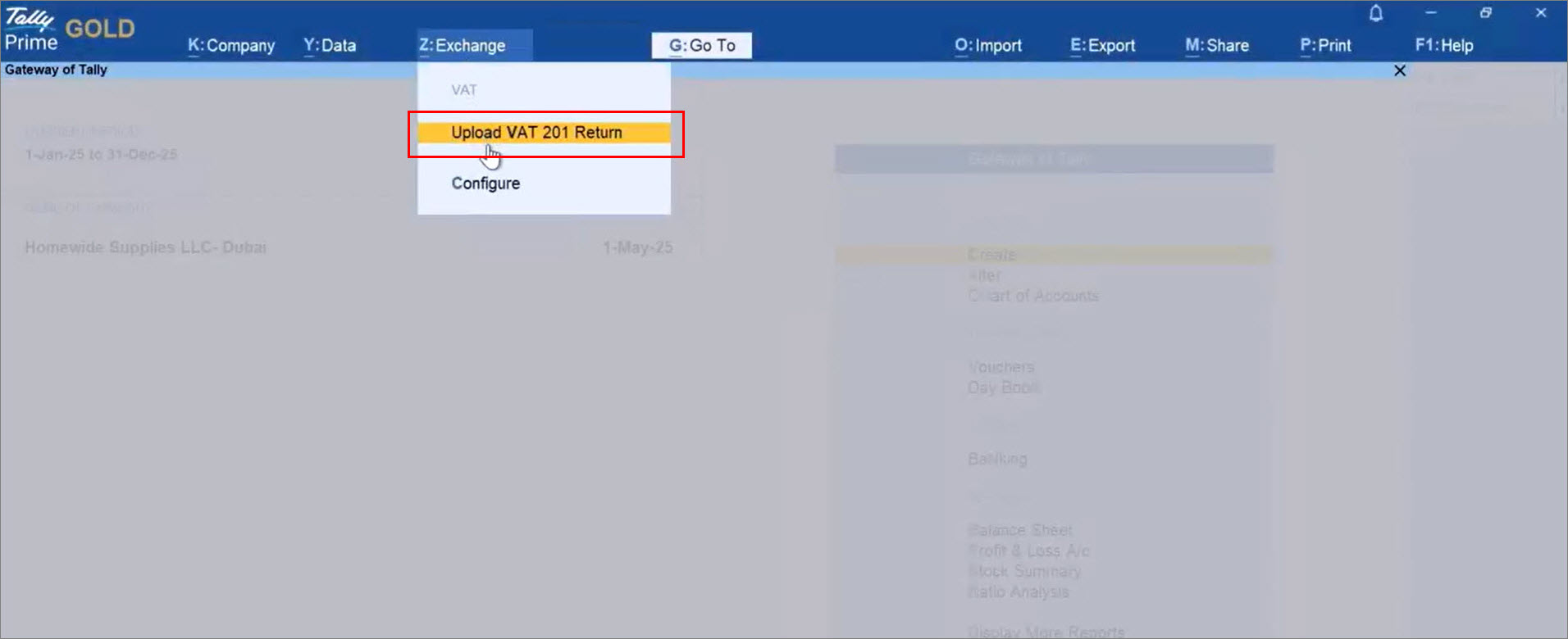

Step 1: Log in to the EmaraTax Portal

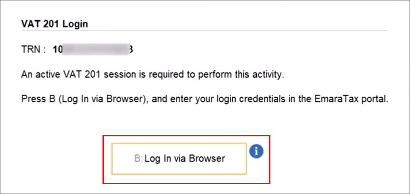

  1. Press Alt+Z (Exchange) > Upload VAT 201 Return.
    upload-vat-201-return
    The VAT 201 Login screen appears.
  2. Press B (Log In via Browser).
    You will be redirected to the official EmaraTax portal via your default web browser.

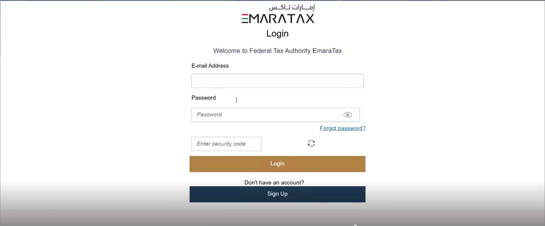

  3. Enter the E-mail Address and Password registered with the FTA.
    emara-tax-login
  4. Click Login.

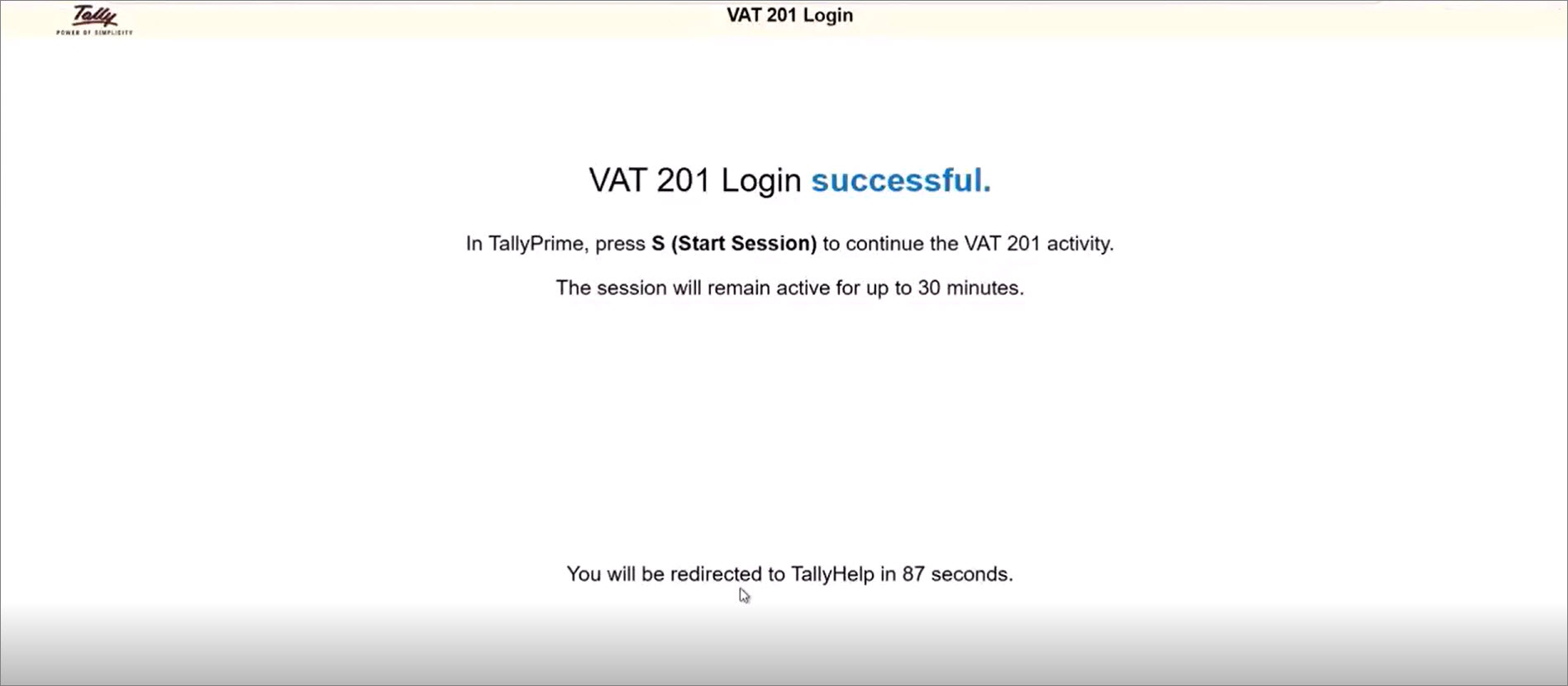

    • On successful login, a confirmation message appears on the browser.
      login-successful
    • If the login fails, an error message will be displayed. You can follow the on-screen instructions to resolve the issue.
Once you have successfully logged in to the EmaraTax portal, you can return to TallyPrime and start the VAT session.

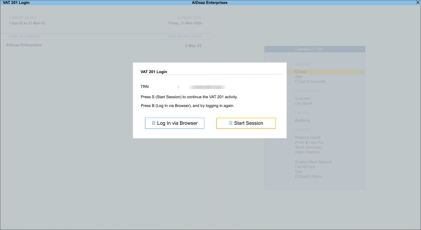

Step 2: Start VAT Session in TallyPrime
  1. Return to TallyPrime.
  2. In the VAT 201 Login screen, press S (Start Session).
    The session will remain active for 30 minutes after a successful login. If a session already exists, you will be directed to the List of Return Statuses screen.

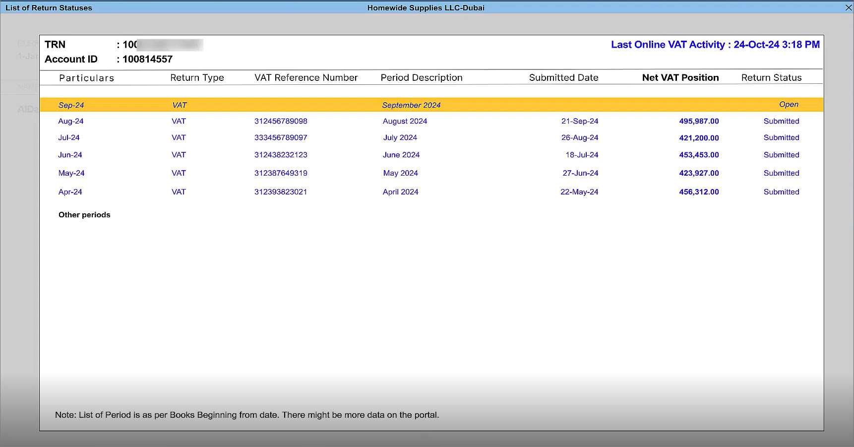

Once you have successfully logged in and started the VAT session, the List of Return Statuses screen appears, displaying the return periods available on the EmaraTax portal.
list-of-return-statuses
You can review the return details for each period:
  • Return Type
  • VAT Reference Number
  • Period Description
  • Submitted Date
  • Net VAT Position
  • Status
The values fetched from the EmaraTax portal will appear in blue.

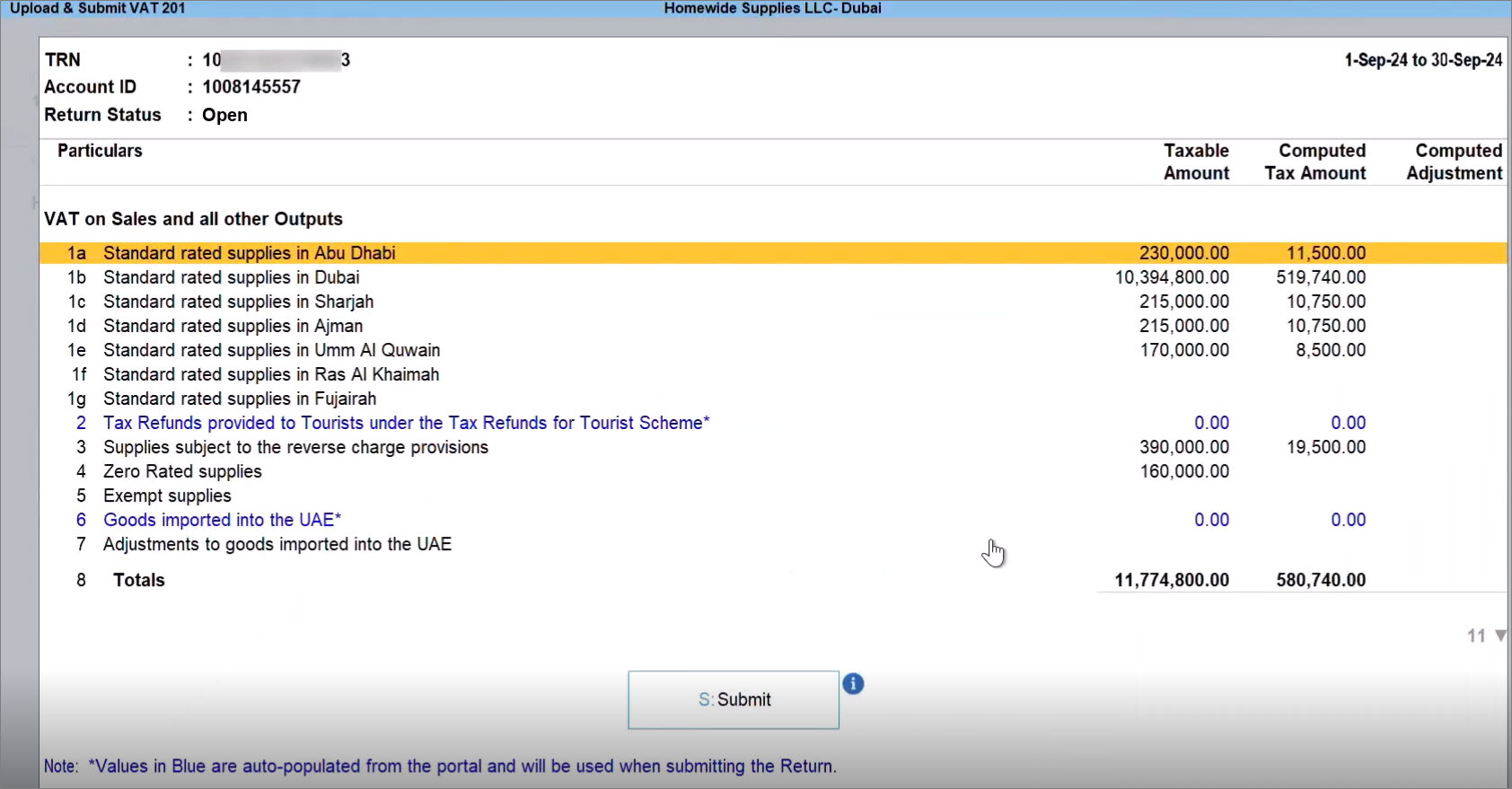

  1. Select the period for which you want to upload the return.
    If there are overdue periods, you must first file the oldest overdue return.
    The Upload & Submit VAT 201 screen appears, displaying the return preview.
    upload-submit-vat-201

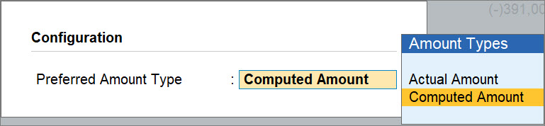

    The following columns appear by default:
    1. Taxable Amount
    2. Computed Tax Amount
    3. Computed Adjustment
    These columns appear when filing the return for the first time from TallyPrime.

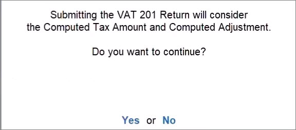

  2. Press S (Submit) to submit the return.
    A confirmation message appears based on the selected amount type.
    submit-confirmation
  3. Select Yes to proceed.

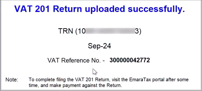

Once the return is uploaded successfully, you will get a confirmation message with the VAT Reference Number.

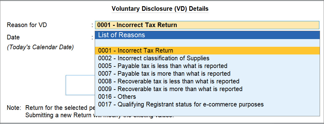

Submit Voluntary Disclosure, if applicable
If the return for the selected period has already been submitted, the action is treated as a Voluntary Disclosure (VD).
The VD Details screen appears.
  1. Enter the following:
    • Reason for VD from the List of Reasons.
      list-of-vd
    • Date of Disclosure.
  2. Press C (Continue) to proceed.
    Once the upload is successful, you will get a confirmation message.
Once the return is successfully uploaded, your UAE VAT 201 e-Return filing through TallyPrime is complete. You can now review the submission details anytime and proceed with other VAT activities as needed.

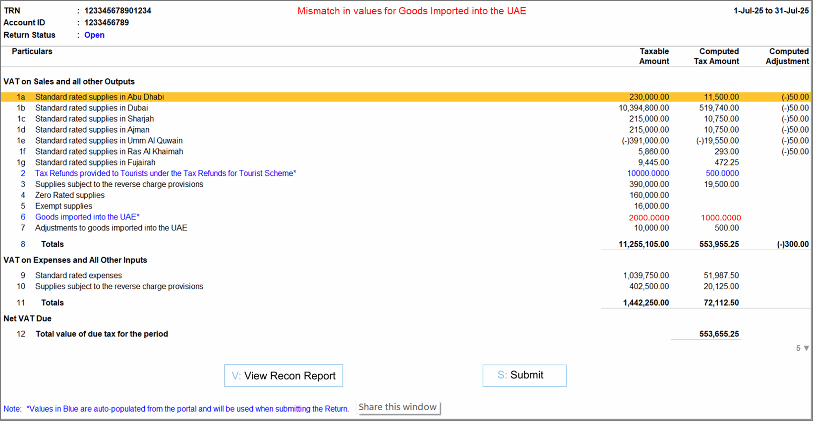

Resolve Mismatch in Values
While uploading the VAT e-Return, TallyPrime compares the values in your Books with the values fetched from the EmaraTax Portal. If any differences are identified for Goods imported into the UAE, a Mismatch in values for Goods imported into the UAE alert appears in red on the Upload & Submit VAT 201 screen.
mismatch-in-values
Only specific sections display colour-coded differences on this screen:
  • The differences in section 6 are highlighted in red.
  • The values in section 2 appear in blue.
  • All other fields appear in black, reflecting the values from your Books.
A mismatch in section 6 may occur when:
  • The values for this section are fetched directly from the EmaraTax Portal.
  • The computed values in your Books differ from the fetched values.
The EmaraTax Portal considers the tax component for section 6 as final, as the values are sourced from the Customs Portal. The values fetched from the Portal are compared with the values in your Books, and you can correct them as required, either in your Books or on the Portal.
For section 2, TallyPrime does not perform any comparison. The values fetched from the Portal are shown as is on the Upload & Submit VAT 201 screen.
A mismatch does not prevent you from uploading the Return. You can:
  • Press S (Submit) to submit the VAT Return along with the mismatched values fetched from the Portal.
  • Press V (View Recon Report) to view the reconciliation between Books and Portal values and identify the exact fields causing the mismatch.

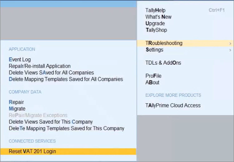

Reset VAT 201 Login
If you face login issues or need to reset your credentials, follow the steps below:
  1. Press F1 (Help) > Troubleshooting > Connected Services > Reset VAT 201 Login.
    reset-vat-login
    A confirmation message appears indicating that the login details for the current TRN and User will be cleared.
  2. Select Yes to confirm.
    Once reset, you will need to log in again using the Log In via Browser option.
