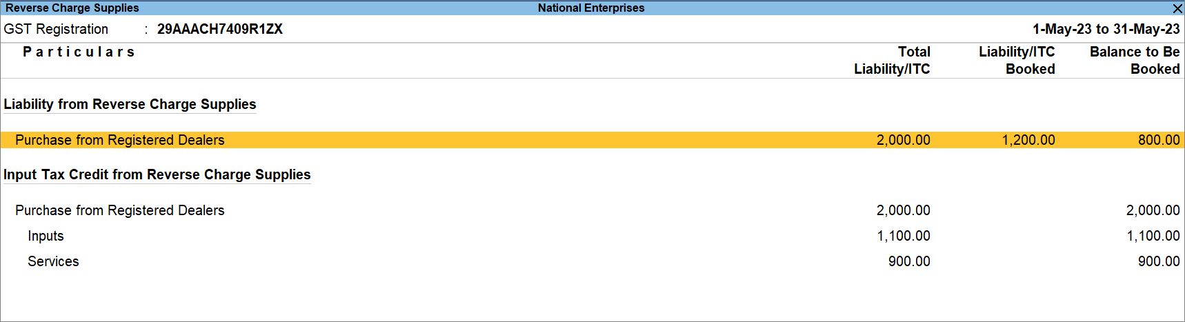

  1. Press Alt+G (Go To) > type and select Reverse Charge Supplies, and press Enter.
    Reverse Charge Supplies Report in TallyPrime
  2. Drill down further from Purchase from Registered Dealers or any other section.
You can also use the report record journal vouchers for booking the pending liability.

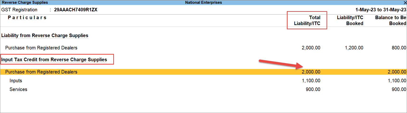

    Input Tax Credit in Reverse Charge Supplies Report in TallyPrime
    Under the column Total Liability/ITC, you get to know the eligible ITC that you can book.

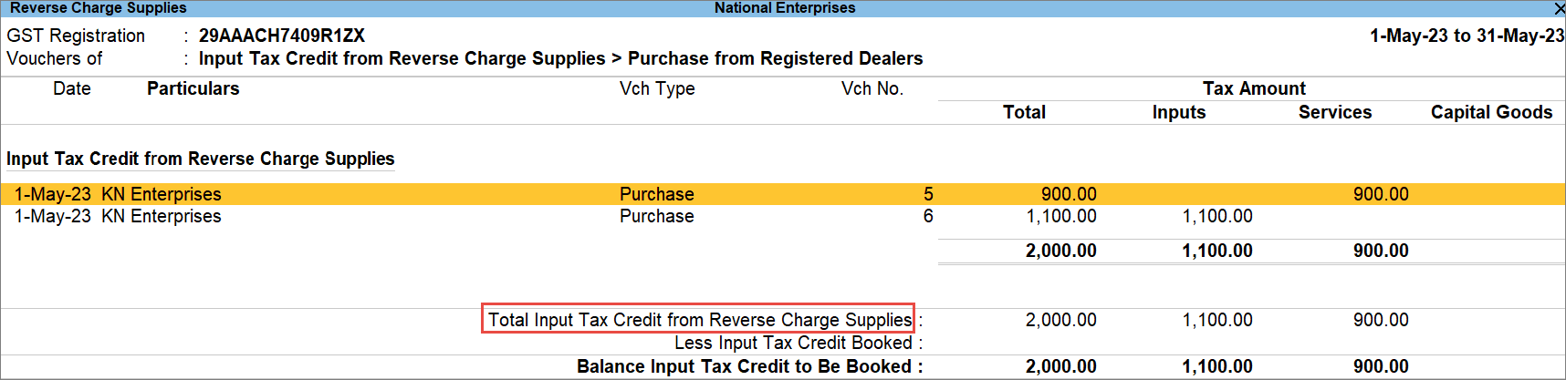

  2. Drill down further from a section under Input Tax Credit from Reverse Charge Supplies.
    Total Input Tax Credit from Reverse Charge Supplies in TallyPrime
    You can view the individual transactions and the Total Input Tax Credit from Reverse Charge Supplies.

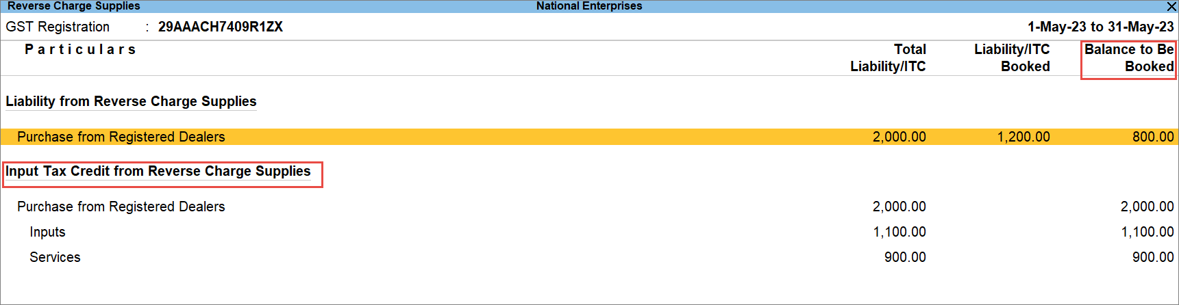

    Balance ITC to be Book in the Reverse Charge Supplies Report in TallyPrime
    In this report, you can view the Balance to Be Booked.

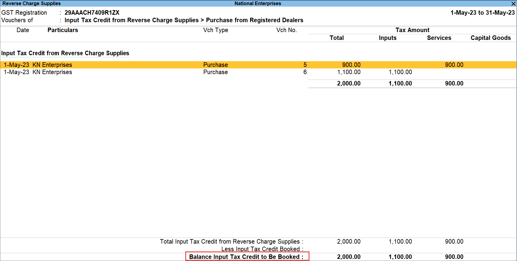

    Input Tax Credit or ITC to be Booked in TallyPrime
    You will get to know the transactions against which ITC is to be booked and the Balance Input Tax Credit to be Booked.
    Balance ITC to be Booked in TallyPrime
