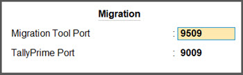

  1. Press Alt+Y (Data) > Configuration > Port.
  2. Update the Migration Tool Port and the TallyPrime Port.
    port-configuration
  3. Press Ctrl+A to save.
