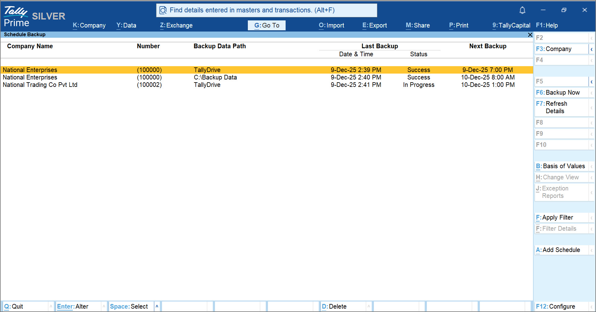

To open the Schedule Backup report,
  • Press Alt+Y (Data) > Backup & Restore > Schedule Backup.

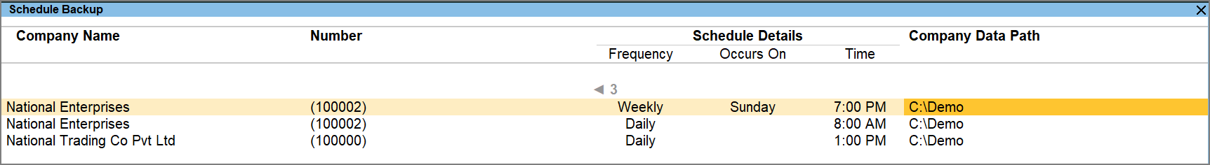

    Schedule Backup Report
The report displays the Company Name, Number, Backup Data Path, Last Backup details such as the Date & Time and Status, and the date and time of the Next Backup.

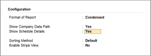

To view the Schedule Details on the report,
  • Press F12 (Configure) and enable the option Show Schedule Details.
Once enabled, you can see the Schedule Details such as the backup frequency, its occurrence, and time.
Schedule Backup Report in TallyPrime
Press Alt+F5 (Detailed) to have a detailed view of the report.

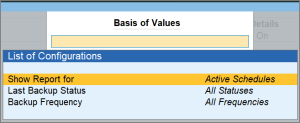

What’s more! You also have the option to configure the report as per the type of schedules, last backup status, and backup frequency from the Basis of Values.
Press Ctrl+B (Basis of Valuses) and configure as required.
Show report for: Configure this option to view the type schedule such as active, paused, completed, or all.
Last Backup Status: Configure this option to view schedules based on the last backup status such as in progress, success, failed, on hold, or yet to start.
Backup Frequency: Configure this option to view schedules based on the backup frequency once, daily. monthly, weekly, or all.
Note that to configure the report as per the Backup Frequency, you must first enable the option Show Schedule Details from F12 (Configure).

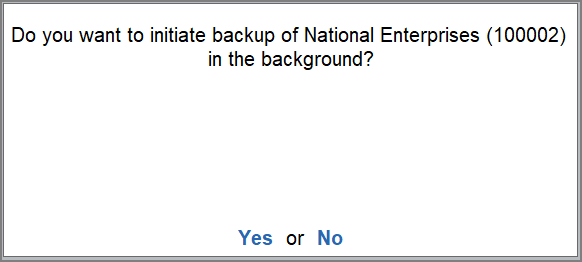

Backup Now
You can also take an immediate backup from the Schedule Backup report when the scheduled backup is set for a later time.
  • Press Spacebar to select the required company and press F6 (Backup Now).
    In case of a TPS company, you will be prompted to enter your Tally.NET ID and Password to log in to TallyPrime Server.
  • Enter the TallyPrime Server credentials.
    Backup Now in TallyPrime
  • Press Y to click Yes to confirm.
    This will initiate a backup of the selected company in the background.

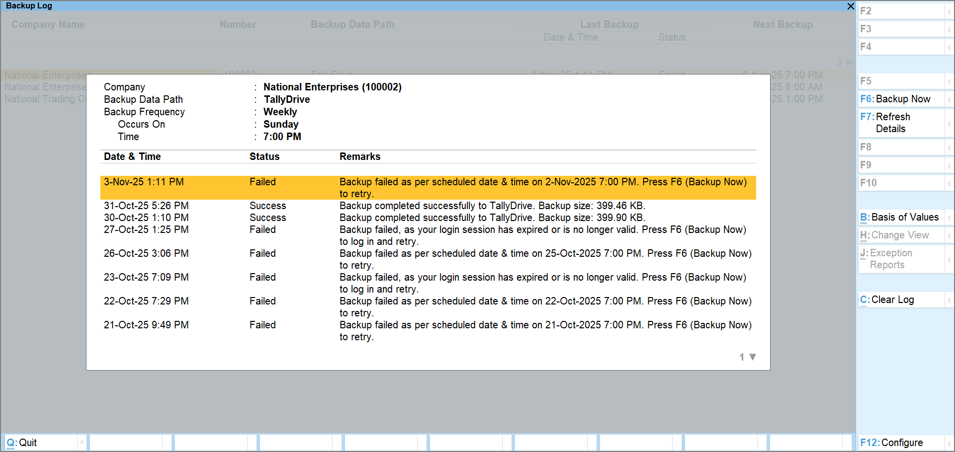

Backup Log
Backup Log in the Schedule Backup report lists all backups taken as part of this backup schedule.
To view the Backup Log,
  • Place the cursor on the required schedule and press Enter.
    Backup Log Report in TallyPrime
The report shows the Company details, Backup Data Path, Backup Frequency, Occurs On, and Time as per the schedule. It also displays the Date & Time of the last backup, its Status, and Remarks to help you understand the status.
If you want to take an immediate backup of the company, press F6 (Backup Now) and press Y or Enter to confirm. This will initiate a backup of the selected company.

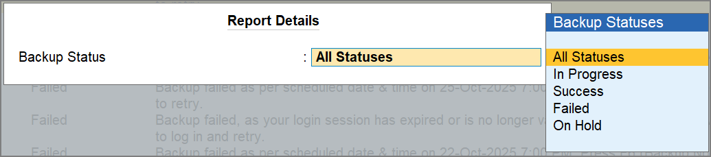

You can configure the Backup Log of a company as per the Backup Status, if required.
Press Ctrl+B (Basis of Values) and select the Backup Status.
Backup Log in TallyPrime
Once configured, the Backup Log will display only the backups as per the selected backup status.

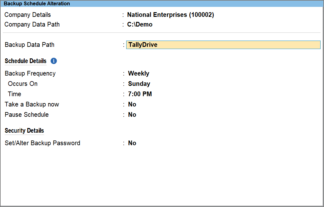

Alter Backup Schedule
The Schedule Backup report in TallyPrime provides you the flexibility to alter the schedules as and when required. Whether the backup was scheduled to TallyDrive or to a local drive, you can alter it from the Schedule Backup report.

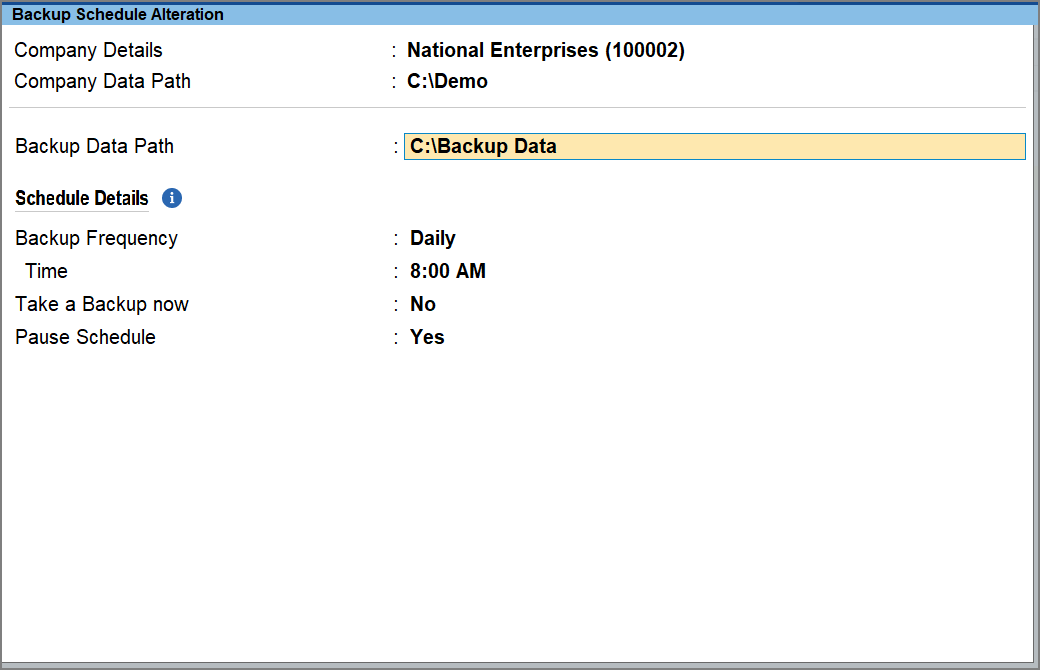

Alter backup schedule of a local drive
To alter a schedule on a local drive,
  1. Select the schedule you want to alter and press Ctrl+Enter (Alter Schedule).
    The Schedule Backup Alteration screen will appear.
    Alter Backup Schedule of a Local Drive in TallyPrime
  2. Alter the schedule details as required.
    If you change the Backup Data Path of a schedule from local drive to TallyDrive, you will get the option to enter the Security Details, and prompted to log in to TallyDrive.
  3. Enable the option Take a Backup Now, if needed.
    It ensures a backup is created immediately after you save the schedule, even if your actual scheduled backup is set for a later date and time.
  4. Enable the option Pause Schedule, if needed.
    It will pause the schedule, and it will not run at the scheduled date and time until you resume it.
  5. Press Ctrl+A to save the schedule.

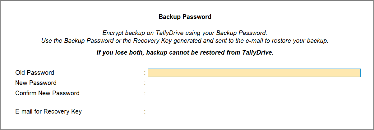

    3. Alter the Security Details, if needed.
      If a Backup Password exists, you can alter, reset, or remove the password, as required.
      You can also add a password if the schedule was created without one.
      1. Under Security Details, enable the option Set/Alter Backup Password.
        • Alter Password: To alter an existing backup password, enter the Old Password and then enter the New Password and Confirm New Password.
          During restore, the new password will be applicable to both previously taken backups and all future backups taken under this schedule.
          Alter Backup Password in TallyPrime
        • Add Password: If the backup password does not exist, you can add the backup password while altering the schedule. To add a Backup Password, enter the New Password and Confirm New Password.
          During restore, the password will be applicable to both previously taken backups and all future backups taken under this schedule.
        • Remove Password: You can also remove the backup password while altering the schedule. To remove the password, enter the Old Password and then keep the New Password and Confirm New Password blank.
          This will remove password protection all the backups taken under this schedule till now, and future backups. Hence during restore, no password will be required.
        • Reset Password: In case you have forgotten the backup password, you can reset the password as well. On the Backup Password screen, press Alt+R (Reset Backup Password) and enter the New Password and New Confirm Password.
          The new password will be applicable only to the upcoming backups taken under this schedule. The existing backups will not be impacted. Hence, the existing backups can be restored only with the old password, and new backups can be restored only with the new password.
      2. In all the above cases, under theE-mail for Recovery Key, enter the email address or multiple addresses where you want to receive the key. The existing recovery key, if any, will no longer be valid. You can use this key to restore your backup if you forget your password. By default, the key is sent to the Tally.NET ID used for your TallyDrive login.

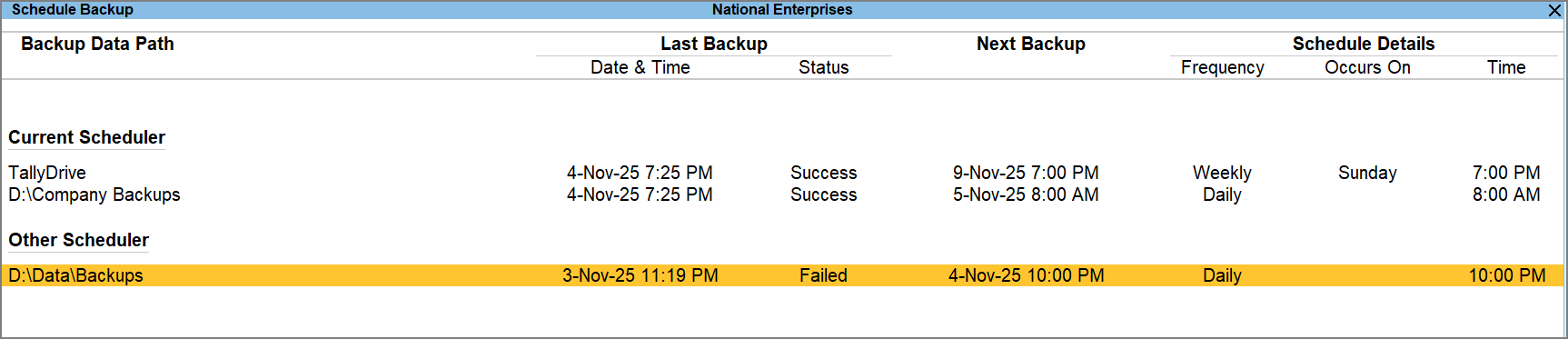

View Schedules On Other Scheduler | Multi-User View
The schedule backup feature in TallyPrime supports multi-user environment. Hence, multiple users can schedule the backup of the same shared company on their systems. To get a consolidated view of all the backups scheduled for company, you can use the Schedule Backup report at company level. It allows you to view the schedules created by other users for a specific company.
  1. Press Alt+Y (Data) > Backup & Restore > Schedule Backup.
  2. Press F3 (Company) to select a company from the loaded companies or press Alt+F3 (Select Company) to select from the List of Companies.
  3. Select the required company and press Enter.
You can see the the backup schedules for the company on the Current Scheduler – the scheduler running on your computer, and Other Scheduler – the scheduler running on other computer or a different installation of TallyPrime done on the same system.
To view the Schedule Details like Last Backup and Next Backup, press F12 (Configure) and enable the option Show Schedule Details.

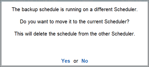

Move backup schedule
TallyPrime gives you the flexibility to move the backup schedule from other scheduler to your current scheduler.
This is useful when the backup schedule is failing on the other scheduler, or when the other user’s system is inaccessible. By moving the schedule, you can continue running the existing backup without interruption.
Once you move the schedule to the current scheduler, it is deleted from the other scheduler.
To move a schedule,
  1. Select the required schedule under Other Scheduler and press Alt+V (Move).
  2. Press Y or click Yes to confirm.
    Move Schedule in TallyPrime
Once moved, the backup will run as per the schedule on your current scheduler.
Once you move a schedule to your Current Scheduler, you can alter it and also take a Backup Now as well, if needed.
