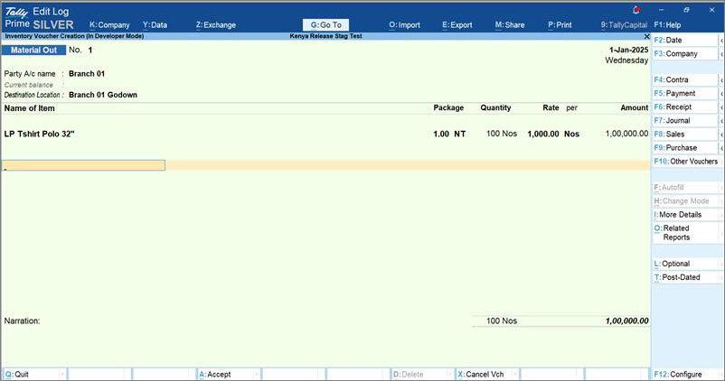

Send stock item details from Head Office to Branch
Let’s say you want to send stock item details from the Head Office to the Branch.
  1. Create Ledgers for Head Office and Branch.
    When creating ledger for Head Office and Branch, ensure to select Branch / Divisions as the group from the List of Groups under which the ledger is created.
  2. Create a Material Out voucher at the Head Office.
    1. Press Alt+G (Go To) > Create Voucher > press F10 (Other Vouchers) > type or select Material Out and press Enter.
      Alternatively, Gateway of Tally > Vouchers > press F10 (Other Vouchers) > type or select Material Out and press Enter.
    2. Party A/c name: Select the ledger created for the Head Office and press Enter.
      The Order Details screen appears.
    3. Specify the required order details.
    4. Press Ctrl+A to save the Order Details.
      The Party Details screen appears.
    5. Provide the party details, or validate the details provided in the party ledger.
    6. Specify the Destination Godown by selecting the Branch as the destination.
    7. Press Enter on the stock item.
      The Item Allocations screen appears.
    8. Specify the Godown and press Ctrl+A to save.
    9. Enter other necessary details in the voucher, as needed.
    10. Accept the screen. As always, you can press Ctrl+A to save.
      A message appears on the screen to confirm whether you want to send the details to eTIMS.
    11. Select Yes to send the details to the eTIMS portal.

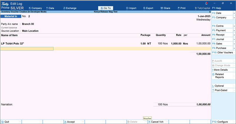

  3. Now, create a Material In voucher at the Branch for the same stock item.
    1. Press Alt+G (Go To) > Create Voucher > press F10 (Other Vouchers) > type or select Material In, and press Enter.
      Alternatively, Gateway of Tally > Vouchers > press F10 (Other Vouchers) > type or select Material In and press Enter.
    2. Party A/c name: Select the ledger created for the Branch and press Enter.
    6. Specify the Source Godown by selecting the Head Office as the source.
    7. Enter other necessary details in the voucher, as needed.
    8. Accept the screen. As always, you can press Ctrl+A to save.
    9. Select Yes to send the details to the eTIMS portal.
The stock item details are updated in the eTIMS portal successfully.
