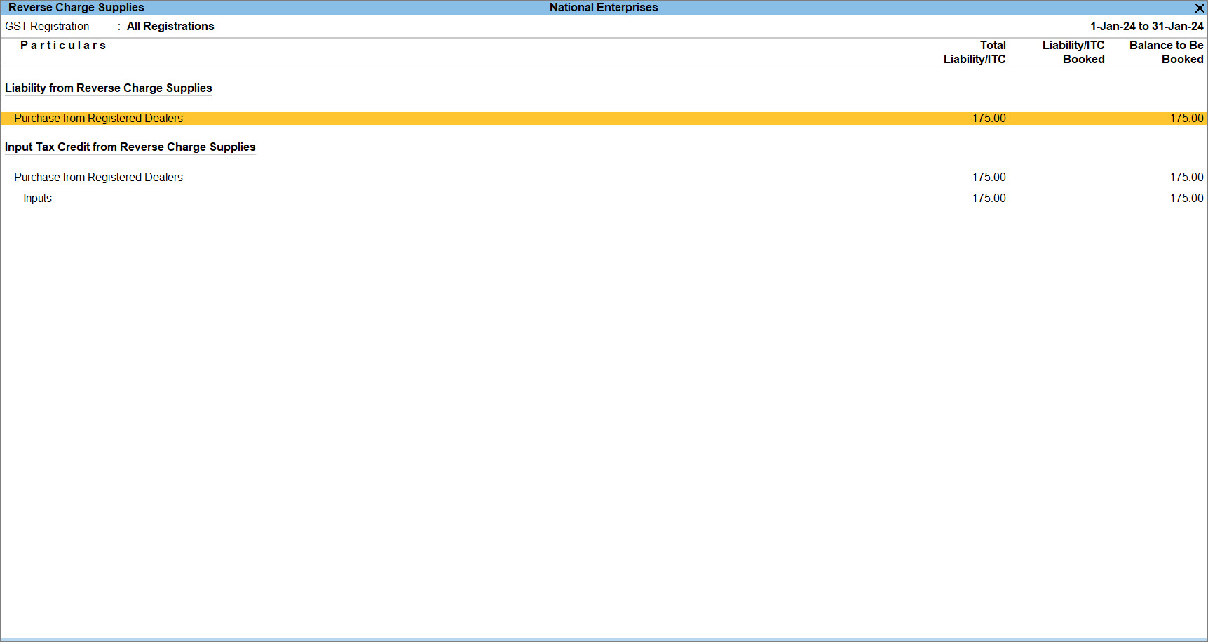

To view the Reverse Charge Supplies report,
  1. Press Alt+G (Go To) > type and select Reverse Charge Supplies.
    reverse-charge-supplies
    If you are using TallyPrime Release 2.0 or earlier, in the GSTR-3B report, drill down from Reverse Charge Inward Supplies.
