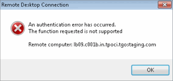

HomeTallyPrimeTallyPrime Cloud AccessAn authentication error has occurred. The function requested is not supported.
authentication-error
Cause
This issue usually occurs on Windows 7 systems where the MSTSC (Remote Desktop) is earlier than version 6.2.
Resolution
Update the MSTSC to a supported version by applying the required Windows update.

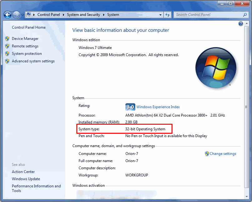

  1. Check the system type.
    1. Go to Control Panel > System and Security > System.
    2. Check whether the system type is 32-bit or 64-bit.
      system-type

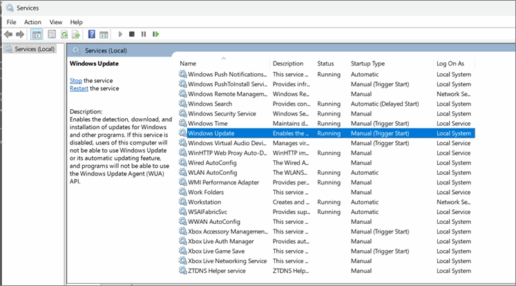

  2. Ensure Windows Update service is enabled.
    1. Press Windows+ R.
    2. Type services.msc and press Enter.
    3. Scroll down and locate Windows Update.
    4. Double-click the service.
    5. Set Startup type to Manual to enable it.
      manual-startup
    6. Click Apply > OK.

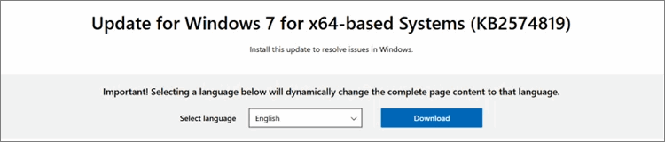

  3. Install the DTLS support update.
    1. Click here to download the update.
      For example:
      1. For 32-bit systems: Download All supported x86-based version of Windows 7.
      2. For 64-bit systems: Download All supported x64-based version of Windows 7.

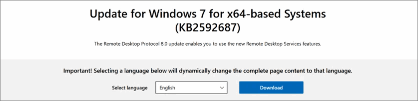

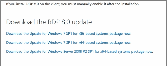

  4. Install the RDP 8.0 update.
      For example:
      1. For 32-bit systems: Click Download the Update for Windows 7 SP1 for x86-based systems package now.
      2. For 64-bit systems: Click Download the Update for Windows 7 SP1 for x64-based systems package now.
