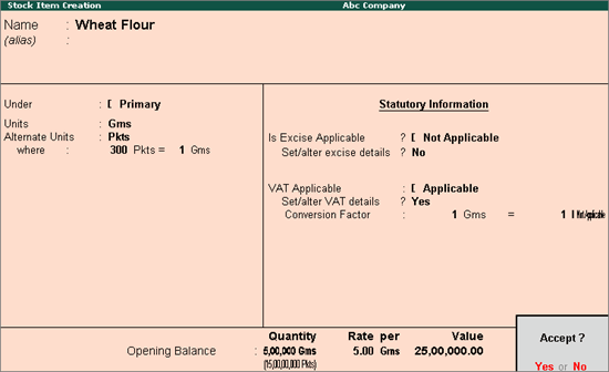

To create a stock item with alternate unit of measurement
1. Go to Gateway of Tally > Inventory Info. > Stock Items > Create.
2. Enter Name, select the group and Units of measurement (basic units of measurement.
3. Select the alternate units of measurement for the item in the field Alternate Units.
4. Enter the conversation rate for the alternate unit and basic unit in the field where.
5. Enter the Statutory Information, as required.
6. Enter the Opening Balance, as required. The completed Stock Item Creation screen appears as shown below:
7. Press Enter to save.
