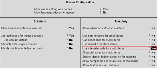

To enable alternate unit of measurement
1. Go to Gateway of Tally > F12: Configure > Accts / Inventory Info.
2. Set the option Use alternate units for stock items? to Yes as shown below:
3. Press Ctrl+A to accept.
Or
1. Go to Gateway of Tally > Inventory Info. > Stock Items > Create.
2. Click F12: Configure.
3. Set the option Use alternate units for stock items? to Yes.
4. Press Ctrl+A to accept.
