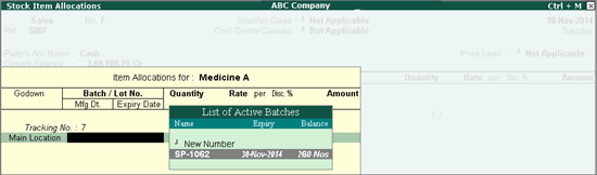

Selecting batch-wise details for sales voucher:
Example:
Record a sales voucher using the following details:
Voucher date:18-11-2014
No. of item: 100 nos.
Price: Rs.15 each
Batch no. SP-1062.
In the List of Active Batches table, only those batches are displayed that have not reached their expiration date as on the sales voucher date. In the above scenario the batch SP-1062 is displayed as the expiry date of the batch is after the sales voucher date i.e., 30-11-2014. If the sales voucher date was on 02-12-2014, the batch would not be displayed in the List of Active Batches table as the expiry date is earlier than the sales voucher date.
This is because the option Honor Expiry Dates usage for Batches is set to YES in F12 Configure (Voucher Entry Configuration).
If you want to list the expired batches during sales entry, set Honor expiry Dates usage for Batches to NO in F12 Configure.
