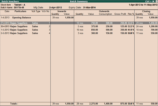

Batch Vouchers provides a list of all vouchers for a stock item of the same batch for a specific period. The report comprises of both inwards and outwards transactions along with quantity, rate and closing value details for the selected batch.
The Batch Vouchers report will be available when the option Maintain batch-wise details is enabled in F11: Inventory Features (F2).
To enable batch-wise details refer Using Batch-wise details.
To view Batch Vouchers report,

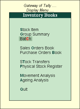

Go to Gateway of Tally > Display > Inventory Books
Select the Batch menu.
Select the required stock item and select the Batch from the List of Batches.
The Batch Vouchers report appears as shown below:

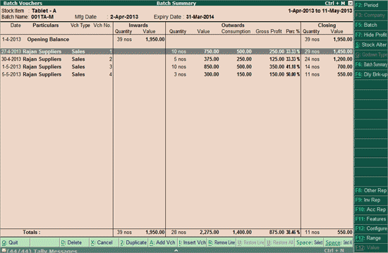

Alternatively, Batch Vouchers report can also be viewed from the Stock Vouchers screen. To view Batch Vouchers report,
Go to Gateway of Tally > Stock Summary
Press Enter and drill down to the Stock Voucher screen.
Press F5: Batch and select the required batch for the selected item, as shown below:
The Batch Vouchers Report appears as shown below:
To view Profitability and Consumption details, press F7: Show Profit button from Batch Vouchers screen. The report will display quantity and value of the opening stock, inward goods, outward goods, closing stock and the value of consumption (using the cost method.

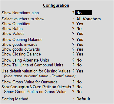

Show Narrations also
Set this option to ‘Yes’ to view the report with narration for all transactions.
Select vouchers to show
By default All Vouchers will be displayed for the selected batches. If you like to view only ‘Inwards’ or only ‘Outwards’ entries, the same can be selected here.
Show goods inwards
Set this option to Yes to display all Inward details, like inward quantities, inward rate and inward value.
Show goods outwards
Set this option to Yes to display all Outward details, like outward quantities, outward rate and outward value.
Show Closing Balance
Set this option to Yes to display closing quantity, rate and value.
Closing Quantity = Opening quantity + Inward Quantity – Outward Quantity
Closing Rate = Closing Value / Closing Quantity
Closing Value = The Closing Stock Value will be based on the Costing Method adopted for each item.
Show using Alternate Units
Set this option to Yes, to display information about alternate units, if stock item is created with alternate units.
Show Tail Units of Compound Units
Set this option to Yes to display information about compound units, if stock item is created with the compound units.
Use default valuation for Closing Values?
(else uses ‘outwards’ value – ‘Inward’ values)
Set this option to No to display the closing value using the formula 'Closing value = Opening value + Inward value – Outward Value'. Transaction value is only for reporting purpose to compare with default valuation. It will not show it in Profit and Loss account.
Show Gross Value for Outwards
Gross value of Outwards refers to that value which is inclusive of the values of VAT/any other allowed ledger under accounting allocation screen of the stock item. By default this option will be set to ‘No’, when it is set ‘Yes’, it will display the gross value of the outwards.
Show Consumption & Gross Profit for ‘Outwards’?
By default this option will be set to No. Pressing F7: Show Profit in the button bar or enabling this option in F12: Configuration will display gross profit / loss of batch selected.
For detailed explanation on each column click here.
Show Gross Profits on Gross Value
By default this option will be set to ‘No’. When this option is set to Yes, the gross profit will be calculated on the Gross Value which is inclusive of the values of VAT/any other allowed ledger under accounting allocation screen of the stock item.
Sorting Method
This will help the user to sort the report Alphabetical wise increasing / decreasing.

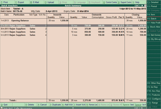

F5: Batch
Navigation to other stock item and batches from the same report is possible.
F6: Batch Summary
Displays the Batch Summary of all the batches for the selected Stock Item. Click here for more details.
F7: Hide Profit
By default, this report displays Batch-wise stock item profitability. Click F7: Hide Profit to hide the same.
Note: This button toggles between Show Profit / Hide Profit.
You can alter the details in the Stock Item Masters, by pressing S: Stock Alter.
