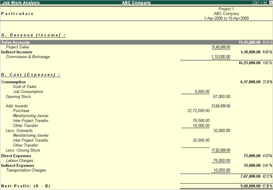

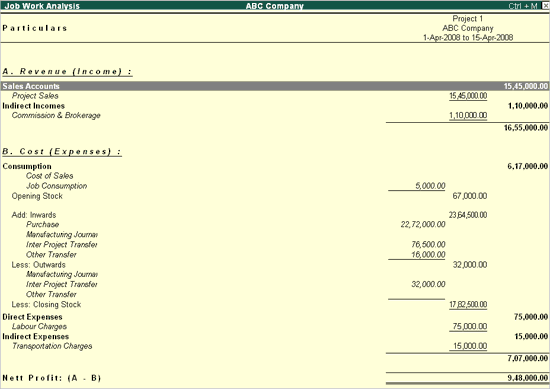

Go to Gateway of Tally > Display > Statement of Inventory > Job Work Analysis
Job Work Analysis report is displayed as shown:

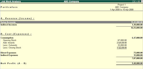

Press Alt+F1 in the Job Work Analysis report, to view a detailed report.
Press F12 in the Job Work Analysis report, and set Show Percentage to Yes.
