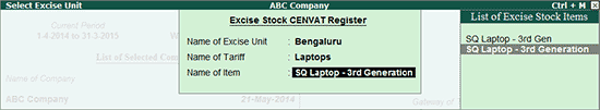

To view Excise Stock CENVAT Register for All Items,
Go to Gateway of Tally >Display > Statutory Reports >Excise Reports >Dealer/Importer > Excise Stock CENVAT Register >One Item
In Select Excise Unit screen, select the Excise Unit, tariff classification and the excise stock item.
Press Enter to accept and generate the report.
