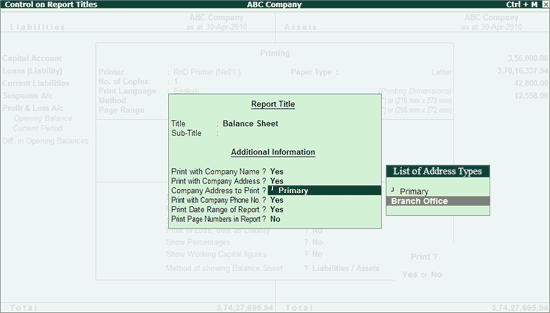

Example: Balance Sheet
Go to Gateway of Tally > Display > Balance Sheet > Alt + P.
From the Print menu, click T: Titling or press Alt + T.
The Control on Report Title screen appears.
Under Additional Information, go to Company Address to Print and select the required Address Types from the list as shown:
Press Enter.
Set the other required options and press Ctrl + A or Enter to go back to the Print menu.

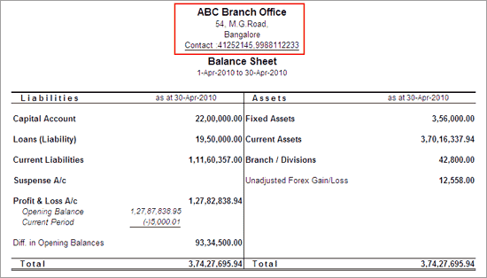

Press Y or Enter to print the report.
The report will print the selected Company Address as shown:

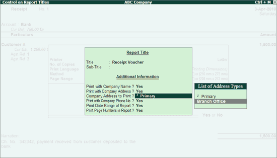

Example: Receipt Voucher
To print the Receipt Voucher with the required address of your company:
Select the Receipt Voucher and click on Print button or press Alt + P.
The Voucher Printing screen appears, click T: Titling or press Alt + T.
Under Additional Information, go to Company Address to Print and select the required Address Type from the list as shown:
Press Enter.

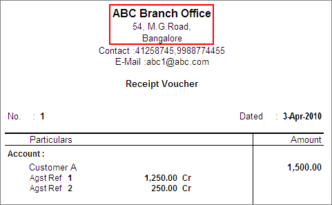

The voucher will print the selected Company Address as shown:
