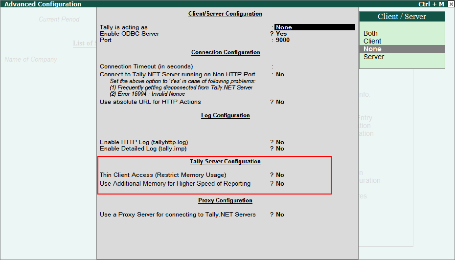

There are two options provided in the Tally.ERP 9 Client machine when data is accessed through Tally.Server,
Thin Client Access (Restrict Memory Usage)
Use Additional Memory for Higher Speed Reporting
To set these configurations
1.
Go to
Gateway of Tally
Company Info.
F12: Configurations
Advanced Configuration
. The options appear under Tally.Server Configurations as shown.
By default, both the options are set to No and normally the user would not require changing them.
2.
Perform one of the following:
Enable
. This is required when Tally.ERP 9 clients and the data reside on a high power server and is accessed through thin clients or RDP. This will indicate to the Tally.ERP 9 client that the data and other clients are also running on the same machine, thereby reducing usage of own memory and thus providing optimum performance as there is no network traffic involved. This will also ensure that other clients do not overload the server memory by each of them trying to cache data for performance.
Note:
If the first option Thin Client Access (Restrict Memory Usage) is enabled, then the second option Use Additional Memory for Higher Speed Reporting becomes irrelevant.
Enable
Use Additional Memory for Higher Speed Reporting:
This is required if the volume of data is very high and there is un-utilised memory on the individual Tally.ERP 9 client machine(s). This will indicate to the Tally.ERP 9 client(s) to consume more local memory (instead of memory on the server) to cache the data, hence providing higher performance.

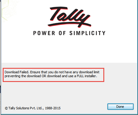

This error occurs while updating Tally.ERP 9 to latest release from Product & Features.
Solution
Open Tally.ERP9 through Admin level and then try to update the release from Product & Features.
