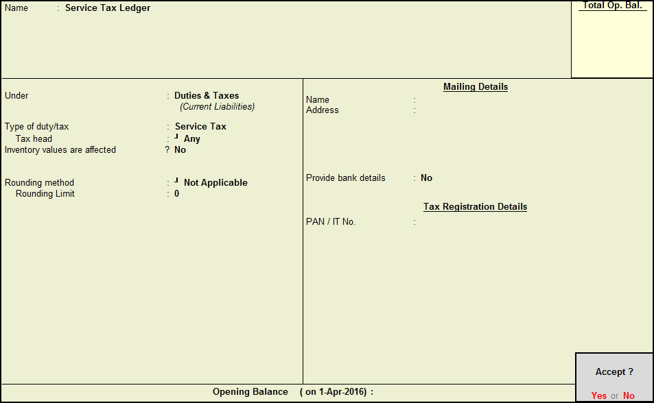

To create Service Tax ledger for current year
1.    Go to Gateway of Tally > Accounts Info. > Ledgers and create the ledger as shown below.
Here we have created a common service tax ledger which can be used to account service tax and cess amount.
Note: If you want to account the service tax amount based on the tax head, you can create the Tax Head based ledgers.

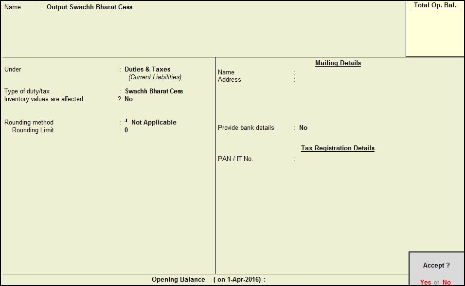

To create output Swachh Bharat Cess ledger

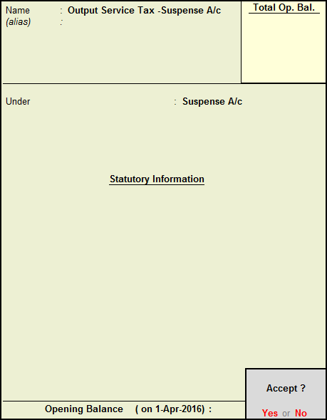

Create Service Tax Ledger for Previous Year

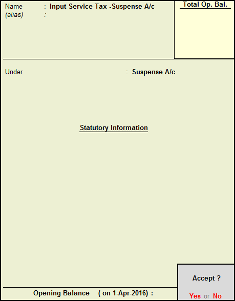

To account the Input credit and Service Tax of Previous year create the Ledger under Suspense A/c.
Note: You can create the Previous Year Tax ledgers under Current Assets/Current Liabilities without enabling the Service Tax feature.
2.    Input Service Tax – Suspense A/c Ledger
3.    Output Service Tax – Suspense A/c Ledger
 Note: User Can Create One ledger to account both input credit and output tax. Here we have created TWO ledgers- One to account inputs and another account to output tax for the better understanding of the functionality.

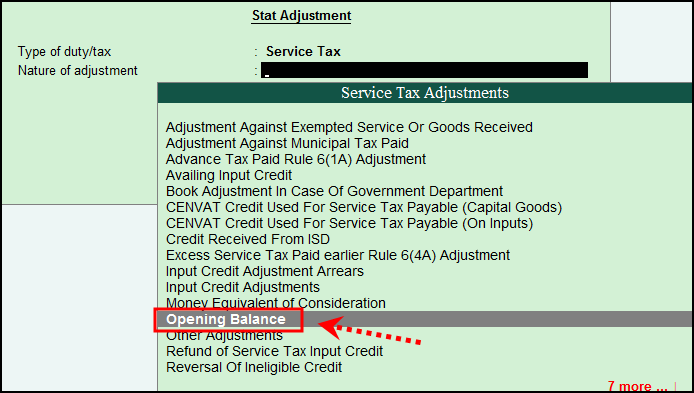

Note: By default, only the basic adjustment flags are displayed. Enable the option Allow All Adjustments Types? Using F12: Configure in Stat Adjustment Details screen to display the entire set of service tax adjustment flags.
4.     In Nature of adjustment select Opening balance.

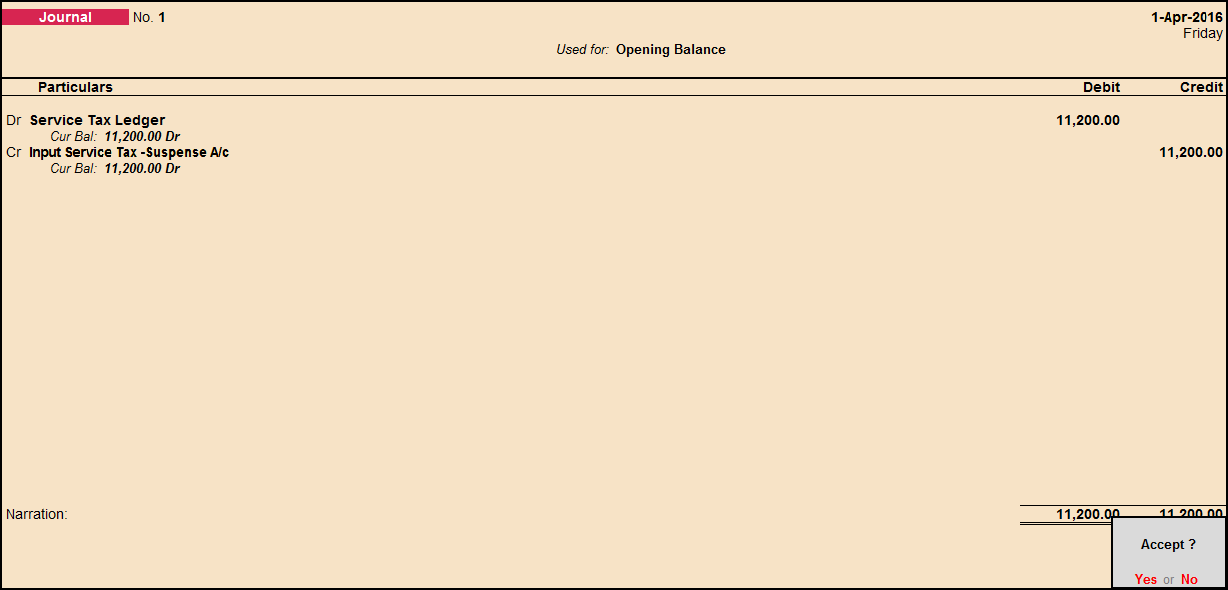

This journal will transfer the pending Input Service Credit of the previous Financial Year current Financial Years Service Tax ledger. The completed Opening balance entry is displayed as shown below.

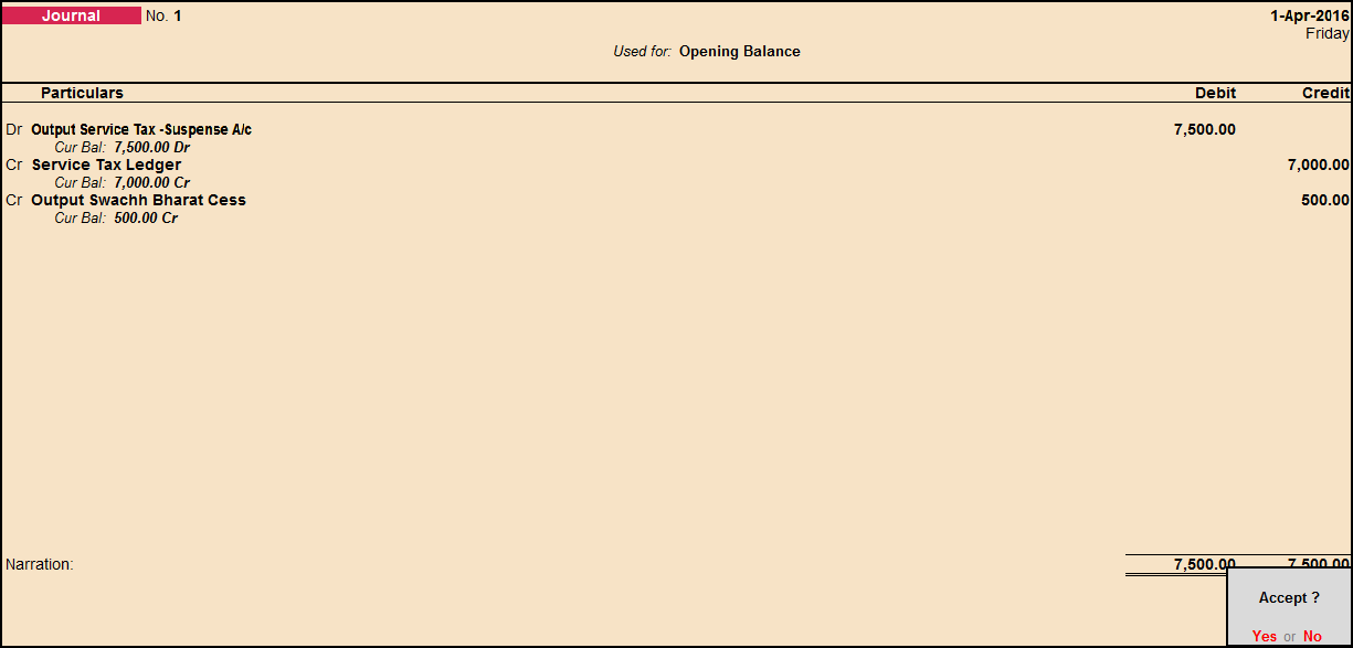

This journal will transfer the pending Service Tax of the Previous Financial Year to current Financial Years’ Service Tax ledger.  The completed Opening balance entry is displayed as shown.
13.  Press enter to accept.

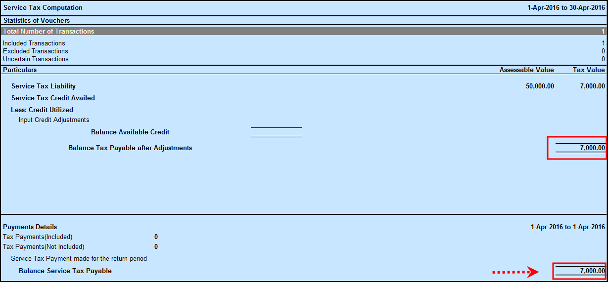

On accounting service Tax Opening balance details will be displayed in Service Tax Computation report.
To view the details Go to Gateway of Tally > Display > Statutory Reports > Service Tax Reports > Form ST3 > Service Tax Computation.
