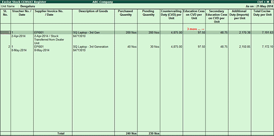

Excise Stock CENVAT Register displays the CENVAT details of goods purchased. Using this report the importer of excisable goods can ascertain the pending quantity and CENVAT duty per unit which can be passed on to the subsequent buyers.

Excise Stock CENVAT Register - All Items
To view Excise Stock CENVAT Register for All Items
1. Go to Gateway of Tally > Display > Statutory Reports > Excise Reports > Dealer / Importer > Excise Stock CENVAT Register > All Items .
2. Select the Excise Unit in the Name of Excise Unit option in Select Excise Unit screen. The Excise Stock CENVAT Register appears as shown below:

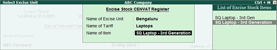

1. Go to Gateway of Tally > Display > Statutory Reports > Excise Reports > Dealer / Importer > Excise Stock CENVAT Register > One Item .
2. Select the Excise Unit, tariff classification, and the excise stock item in the Select Excise Unit screen.
3. Press Enter to accept and generate the report.

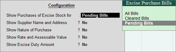

F12: Configure
To configure Excise Stock CENVAT Register - All Items\One Item report
1. Click F12: Configure .
The Configuration screen appears as shown below:
Show Purchases of Excise Stock for : Select the required type of purchase bills - All Bills , Cleared Bills or Pending Bills . Excise Stock CENVAT Register displays details according to the option selected.
Show Supplier Name and Address : Enable this option to view the name and address of the supplier. By default this option is set to No .
Show Nature of Purchase : Enable this option to view the nature of purchase (like Manufacturer, First Stage Dealer etc.)
Show Rate and Assessable Value : Enable  this option to view the rate and assessable value of the excise stock.
Show Excise Duty Amount : Enable this option to view the total excise duty paid on the excise stock. By default the report will display the Duty per Unit.
