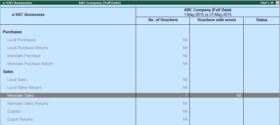

1. Go to Gateway of Tally > Display > Statutory Reports > VAT > Form VAT 100 > Annexure Ready . The e-VAT Annexures report appears as shown below:

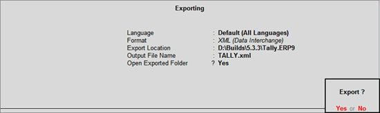

2. Press Alt+E to view the Exporting screen.
3. Press Enter to export the annexure.
