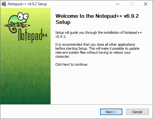

To download notepad++
1. Download the Notepad++ installer.
2. Run the installer.
3. Select the preferred language.
4. Click on OK . The Notepad++ Setup Box appears.
5. Click Next .
6. Click I Agree in the License Agreement Box.
7. Choose your destination folder and click on Next> . The Choose Components Box appears.
8. Click on Next>
9. Click on Install to complete the installation process .
10. Click on Finish after the installation is complete.
Notepad++ opens after installation.
