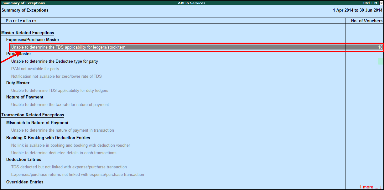

Unable to determine the TDS applicability for the ledger/stock item
Cause
Expense/purchase ledger/Stock item used in the transaction is not enabled with TDS and TDS category.
Solution
This exception can be resolved by selecting appropriate TDS nature of payment.
To resolve this issue

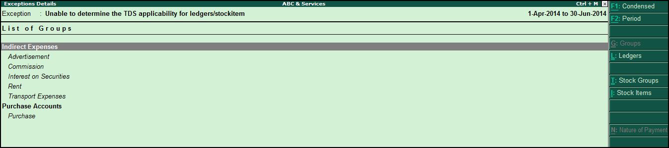

1. Press Enter on the above exception. List of Groups appears.
2. Press space bar on group.

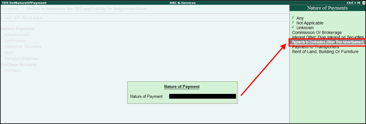

3. Press Alt+N : Nature of Payment .
4. Select list of nature of payment from the list and accept the screen.
