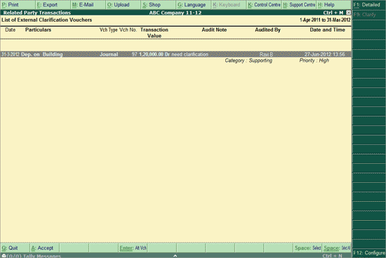

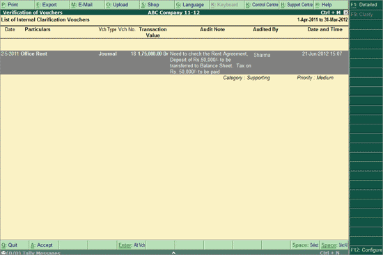

1. Go to Gateway of Tally > Display > Statement of Accounts > Audit & Compliance Info. > Statutory Audit Info.
2. Drill down into the required column, External Clarification or Internal Clarification .
3. List of External Clarification Vouchers screen displays the Voucher details for which the Clarification is asked by the auditor along with the Audit Note and name of the auditor (Audited By).
The List of Internal Clarification Vouchers screen displays the Voucher details for which the Clarification is asked by another user within the organisation along with the Audit Note and Name of the User (Audited By).

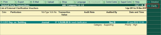

Button options in the List of Internal Clarification Vouchers screen
F1 : Detailed : Click F1 : Detailed or press Alt+F1 to view the detailed report.
F9: Clarify : Click F9 : Clarify button or press F9 provide the necessary Clarification to the Auditor. The Clarification process is explained below in detail.

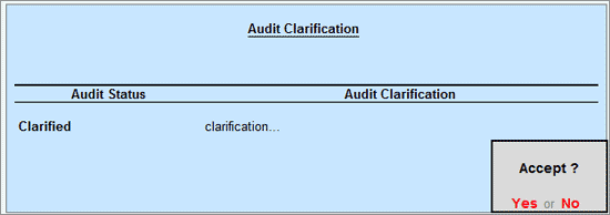

The Audit Clarification screen appears as shown below:
3. Enter the required clarification remarks and press Enter .
Once the Audit Clarification is saved with the Clarification remarks, the Voucher will disappear from the Audit Vouchers screen and the same will be listed under Clarified (To be re-audited) with the Audit Status as Clarified along with the Clarification remarks.
