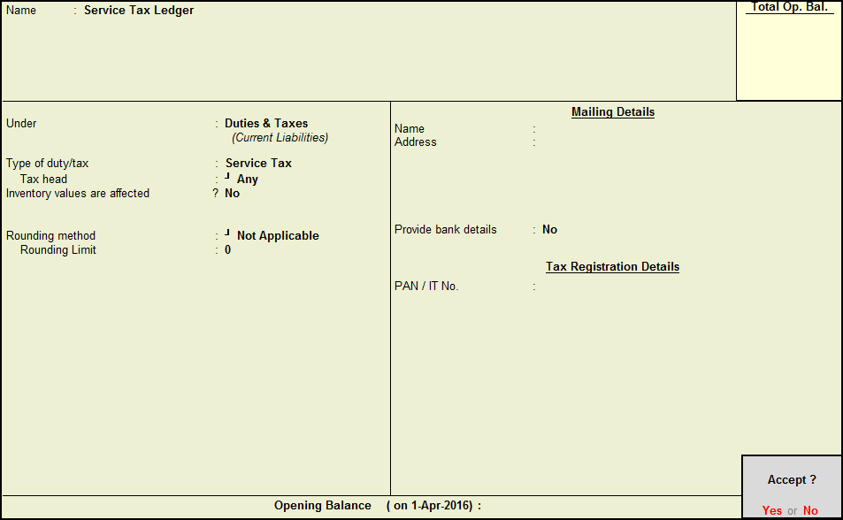

To create Service Tax ledger for current year
1. Go to Gateway of Tally > Accounts Info. > Ledgers and create the ledger as shown below.
Here we have created a common service tax ledger which can be used to account service tax and cess amount.

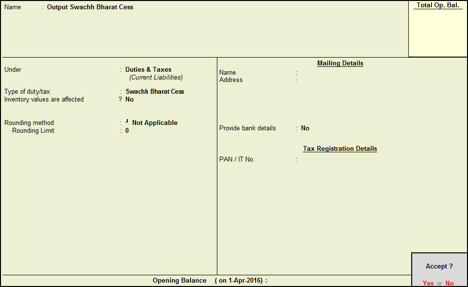

To create output Swachh Bharat Cess ledger

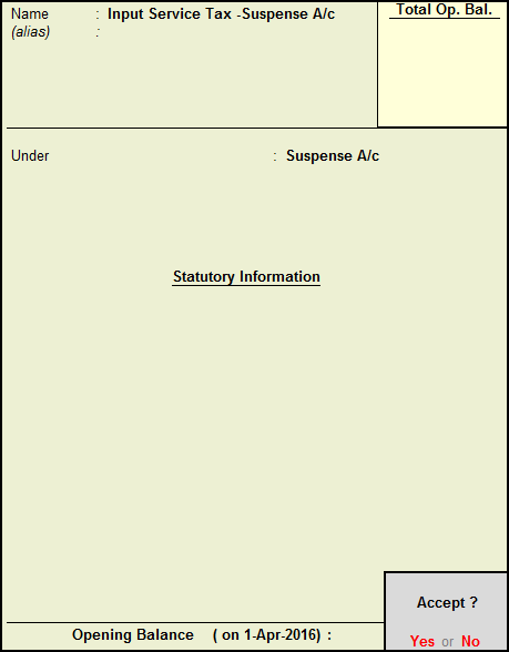

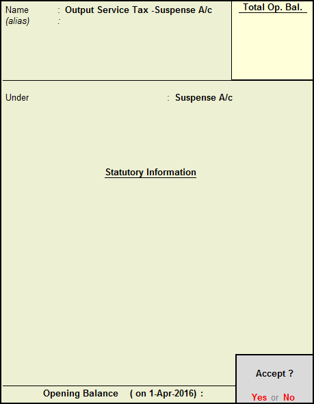

To account the Input credit and Service Tax of Previous year create the Ledger under Suspense A/c.
Note: You can create the Previous Year Tax ledgers under Current Assets/Current Liabilities without enabling the Service Tax feature.
2. Input Service Tax – Suspense A/c Ledger
3. Output Service Tax – Suspense A/c Ledger
Note: User Can Create One ledger to account both input credit and output tax. Here we have created TWO ledgers- One to account inputs and another account to output tax for the better understanding of the functionality.

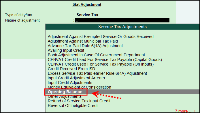

4.     In Nature of adjustment select Opening balance.

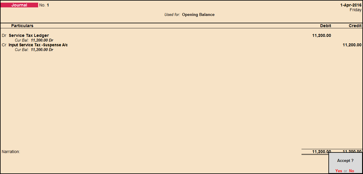

5. In Debit field select Service Tax Ledger from the List of Ledger Accounts created for the current year and press enter to view Service Tax Ledger.
6. In Credit field select the Input Service Tax Ledger created under Suspense A/c for previous year. Amount of Rs. 11200 will be defaulted automatically.
This journal will transfer the pending Input Service Credit of the previous Financial Year current Financial Years Service Tax ledger. The completed Opening balance entry is displayed as shown below.

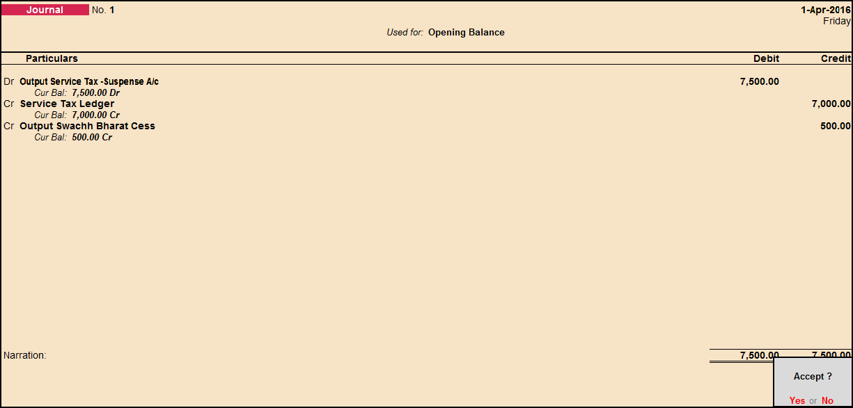

6. In Debit field select Output Service Tax Ledger from the List of Ledger Accounts created for the current year.
7. In Amount field enter the Service Tax (Liability) amount Rs. 7500
8. In Credit field select Service Tax Ledger created for the current Financial Year.
9. In amount field enter the Output Service tax (Liability) amount Rs 70000
10. In Credit field select Output Swachh Bharath Cess Tax ledger from the List of Ledger Accounts created for the current year.
11. In Amount field enter the Swachh Bharat Service Tax (Liability) amount Rs. 500.
12. Accept the Service Tax Details screen.
This journal will transfer the pending Service Tax of the Previous Financial Year to current Financial Years’ Service Tax ledger.  The completed Opening balance entry is displayed as shown.

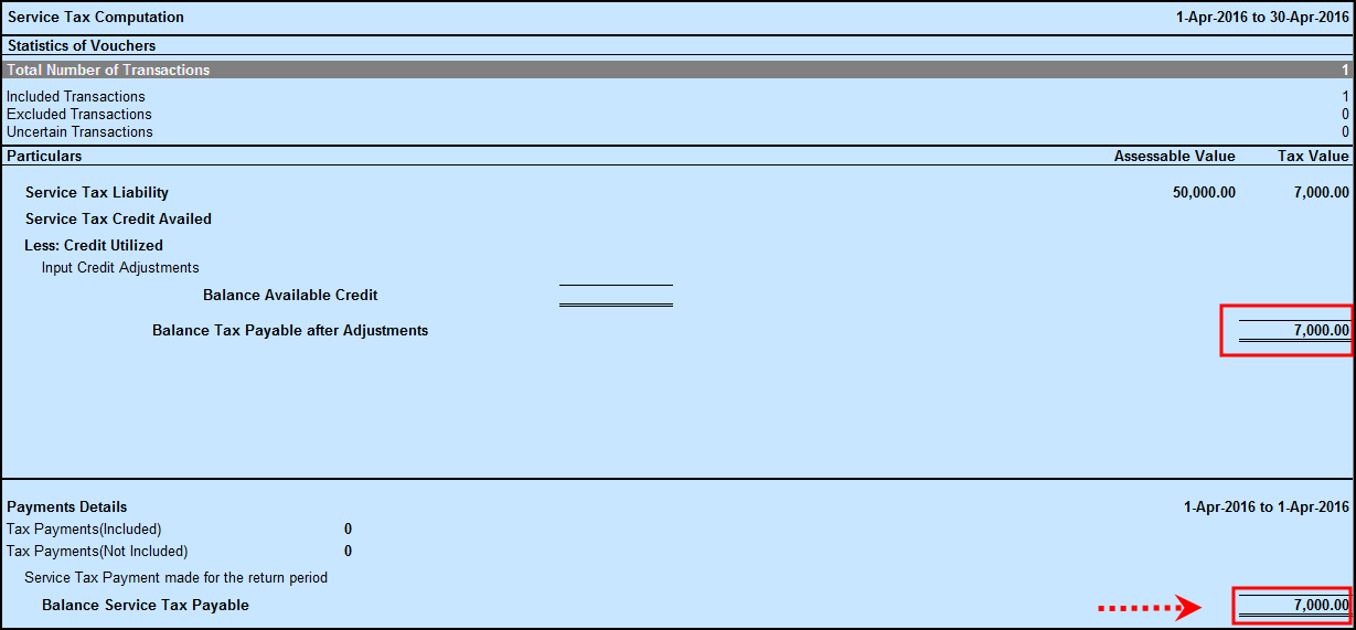

On accounting service Tax Opening balance details will be displayed in Service Tax Computation report.
To view the details Go to Gateway of Tally > Display > Statutory Reports > Service Tax Reports > Form ST3 > Service Tax Computation.
