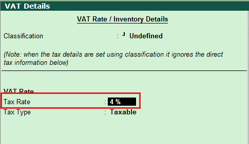

Go to Inventory Info > Stock Groups > Alter . Make Set/Alter VAT details as Yes.
In Tax Rate field, enter the VAT rate applicable for the stock group as shown below-
Enter the date from when this VAT rate is applicable in Applicable From field and accept the configurations.
