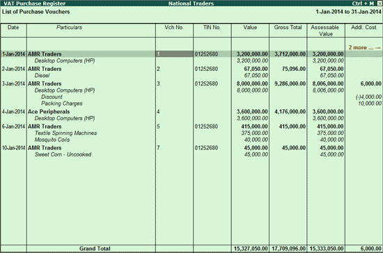

VAT Purchase Register
The VAT Purchase Register provides complete details of all the purchases made in a particular tax period. This register captures the invoice-wise purchases with voucher number, VAT registration number, stock items invoiced, invoice value, assessable value, apportioned additional expenses, VAT/Tax classifications and tax amount.
To view the VAT Purchase Register
1. Go to Gateway of Tally > Display > Statutory Reports > VAT > VAT Register > Vat Purchases .

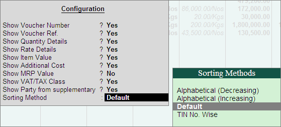

2. Press F12: Configure .
3. S et all the options to Yes for obtaining the complete purchase details.
The options shown in the Configuration screen are:
o Show Voucher Number : This field will be set to Yes to display the voucher number.
o Show Voucher Ref. : Set it to Yes to display the Reference Number entered in the purchase invoice.
o Show Quantity Details : This field will be set to Yes to display the quantity purchased.
o Show Rate Details : Set it to Yes to display the rate at which the stock items were purchased.
o Show Item Value : Set it to Yes to display the assessable value of stock item purchased.
o Show Additional Cost : This field will be set to Yes to display the value entered while invoicing for additional expense or income ledger enabled for apportionment.
o Show MRP Value : Set it to No .
o Show VAT/TAX Class : Set it to Yes to display the VAT/TAX Class column. The VAT/Tax classifications selected while recording purchase transactions will be captured here.
o Show Party from supplementary : Set this to Yes to display party details selected using Party List button in supplementary details / Party Details screen while recording cash purchases.
o Sorting Method : Select the required option to sort based on TIN or the alphabetical order (increasing/decreasing order) of party names and display the list of transactions.

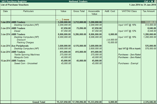

4. Press F1 : Detailed to display the inventory details and VAT/Tax classifications in the VAT Purchase Register screen.
5. Scroll horizontally to view the columnar details.

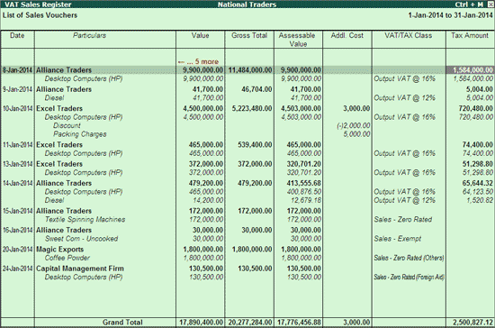

VAT Sales Register
The VAT Sales Register provides complete details of all the Sales made in a particular tax period. It is a register which captures the invoice-wise Sales with voucher number, VAT registration number, stock items invoiced, invoice value, assessable value, apportioned additional incomes, VAT/Tax classifications and tax amount.
To view the VAT Sales Register
1. Go to Gateway of Tally > Display > Statutory Reports > VAT > VAT Register > Vat Sales .
3. Set all the options to Yes for obtaining the complete sales details.

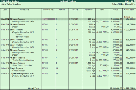

o Show Voucher Ref : Set it to Yes to display the voucher reference number entered in Ref field of sales/tax invoice.
o Show Quantity Details : This field will be set to Yes to display the quantity sold.
o Show Rate Details : Set it to Yes to display the rate at which the stock items were sold.
o Show Item Value : Set it to Yes to display the assessable value of stock item sold.
o Show VAT/TAX Class : Set it to Yes to display the VAT/TAX Class column. The VAT/Tax classifications selected while recording sales transactions will be captured here.
o Show Party from supplementary : Set this to Yes to display party details selected using Party List button in supplementary details / Party Details screen while invoicing cash sales.
In the VAT Sales Register screen, press F1 : Detailed button (Alt+F1) to display the inventory details and VAT/Tax classifications.
4. Scroll horizontally to view the columnar details.
