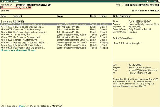

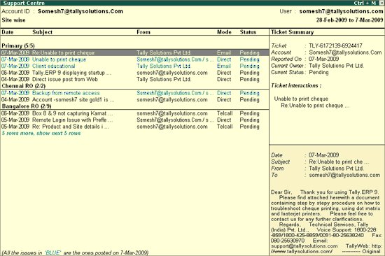

Site Filter - All
Select the option All under Site to display all the queries/ issues, of all the Sites/ Locations based on the Group by option selected.
Site Filter – Site (Selecting a Site from the list)
Select a Site , say 'Bangalore RO’ from the list of Sites to display the query list pertaining to the selected Site, as shown:
Note: The F8: Site Filter option will be available only in case of Multi Site licensing. In case you have selected a Site, from the list of sites by pressing F8: Site Filter, the query list will display the Site ID on the  top left (below the Account ID) in the Support Centre screen, as shown.
