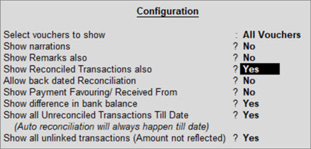

2. Press F12 and set the option Show Reconciled Transactions also? to Yes .

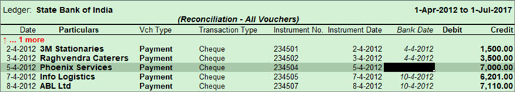

Now only the reconciled transactions will appear, as shown below:
3. Press Space Bar to remove the bank date against the transaction.
4. Press Ctrl+A to accept the changes.
