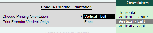

1. Press Alt+N in the Sample Cheque Printing screen. The Cheque Printing Orientation screen appears as shown below:
The Cheque Printing Orientation screen displays the following options:
Option
Description
Horizontal
This option prints the cheque horizontally (oriented as landscape).
Vertical -Centre
This option prints the cheque vertically at the centre of the paper.
Vertical -Left
This option prints the cheque vertically on the left hand side of the paper.
Vertical -Right
This option prints the cheque vertically on the right hand side of the paper.
Note: You can print the cheque face up or face down with vertical orientation using the option Print From(for Vertical Only) .
Select Front for printers that print face up .
Select Rear for printers that print face down.

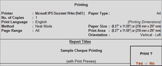

2. Click Alt+I to preview the cheque to be printed. The Sample Cheque Printing screen appears as shown below:
3. Press Ctrl+A to accept.
