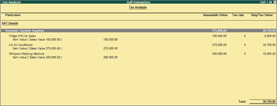

Domestic Sales

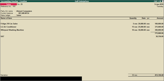

Domestic sales refers to the sale of goods or services to customers within the country.
Record domestic sales

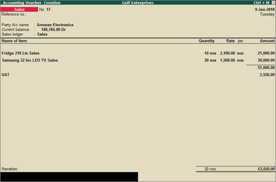

2. In Party A/c name , select the customer ledger. You can select cash ledger for retail or over the counter sales.
3. Select the sales ledger.
4. Select the required items, and specify the quantities and rates.
5. Select the VAT ledger.

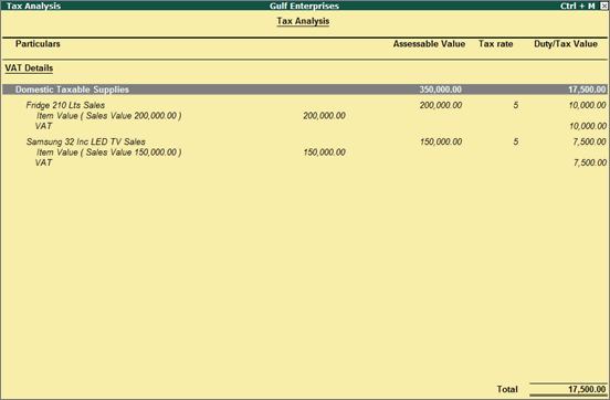

You can view the tax details by clicking A : Tax Analysis . Click F1 : Detailed to view the tax break-up.

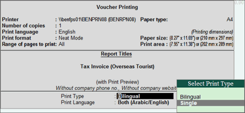

6. In the sales invoice, press Alt+P to print the invoice in the required format.
7. In the Voucher Printing screen, you can select Single or Bilingual as the Print Type . Both English and Arabic will be printed in bilingual copy.
8. Select Print Language as Arabic or English .
Printed Invoice Format
Details such as the tax rates and the TRN/TIN of the company and the customer will be captured. Depending on your requirements, you can include additional details in your invoice by clicking F12: Configure .
Simple and detailed format prints can also be configured using the Print in simple format? option by clicking F12: Configure .

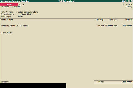

Record sales to registered dealers in GCC countries
2. Select the registered dealer ledger in the Party A/c name field.

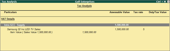

Click A : Tax Analysis to view the tax details. Click F1 : Detailed to view the tax break-up.
Tax will not be calculated for goods sold to a registered party.

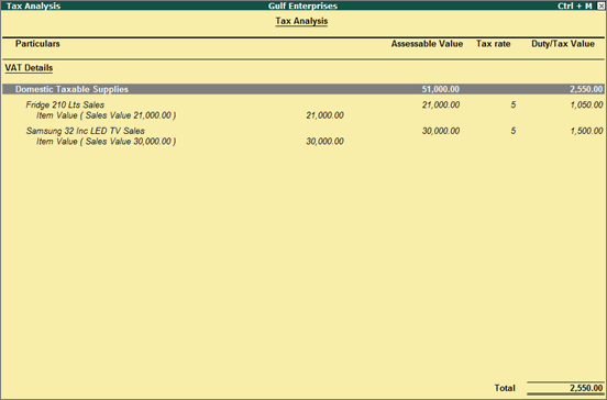

Tax will be calculated for goods sold to an unregistered party

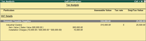

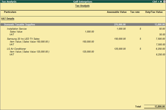

Sale of Goods and Services in a Single Invoice
You can record the sales of both goods and services in the same invoice by selecting the required sales and VAT ledgers.

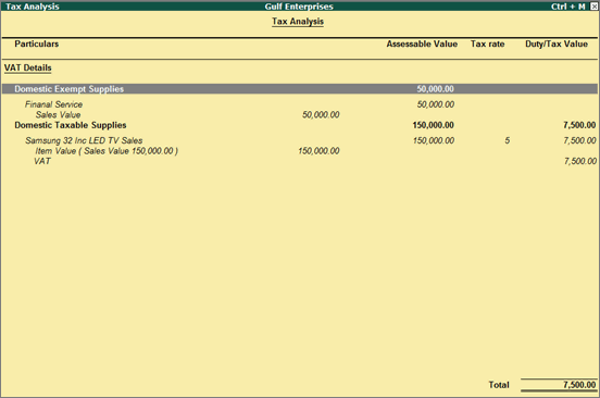

Sale of Taxable and Exempt Items in a Single Invoice
You can record the sale of both taxable and exempt goods or services in the same invoice by selecting the required sales and VAT ledgers.
Select the taxable goods or services and exempt goods or services in the same invoice.
You can view the tax details by clicking A : Tax Analysis . Click F1 : Detailed to view the tax break-up. Tax will not be calculated on exempt items.

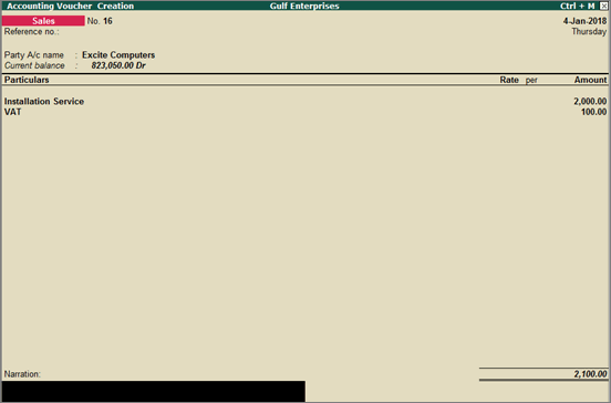

Sales in the Accounting Invoice Mode
When you maintain only accounting transactions (but not the inventory of your goods), or when your company deals with services, you can use the accounting invoice mode for recording your local and intra-GCC sales.
Record sales in the accounting invoice mode
2. Click I : Accounting Invoice .
3. Select the required service ledgers, and specify the rate or amount. Alternatively, press Alt+C to create the ledgers.
4. Select the VAT ledger.
5. Press Ctrl+A to accept.

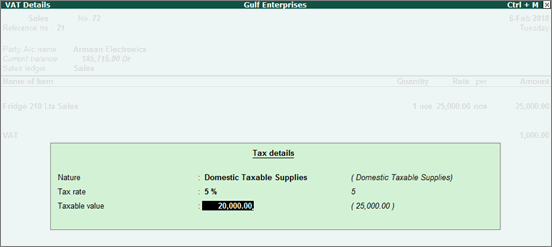

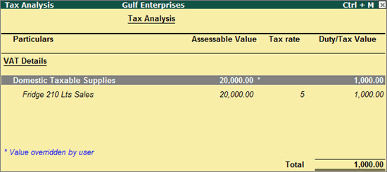

Override Tax Details in an Invoice
In Tally.ERP 9, you can override the tax details in transactions by enabling the override feature in the sales invoice. You can change the nature of transaction, taxable value, and tax rate, as required.
Record sales by overriding tax details

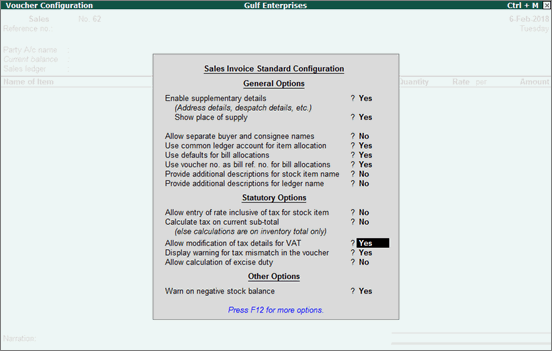

2. Click F12: Configure to configure the sales invoice for overriding tax details.
Enable the option Allow modification of tax details for VAT? and press Ctrl+A to accept.

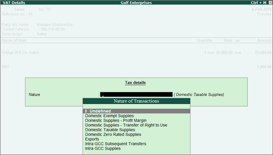

3. Select the customer ledger in Party's A/c Name option.
4. Select the sales ledger.
5. Select the required stock items whose VAT rates are specified either at the stock group level or at the stock item level. Specify the Quantity and Rate for the stock item and press Enter from the Amount field.
The VAT Details screen with the default nature of transaction based on the party location and sales ledger appears as shown below:
o If you want to alter the taxable value and tax rate, press F12: Configure , and enable the options as shown below:
o Press Enter .
6. You can choose to make changes to the nature of transaction, taxable value, and tax rate.
7. Press Enter to return to the invoice screen.
8. Select the common VAT ledger. The sales invoice appears as shown below:

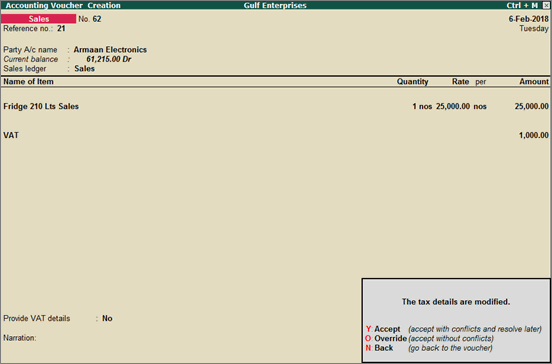

9. Press O to override the default tax details.
Note: In The details are modified button, press Y to accept the voucher with conflicts, you can resolve them in the VAT returns report. Press N to go back to the voucher and make changes. When you press O the voucher is accepted without tax conflicts and is directly included in the returns.

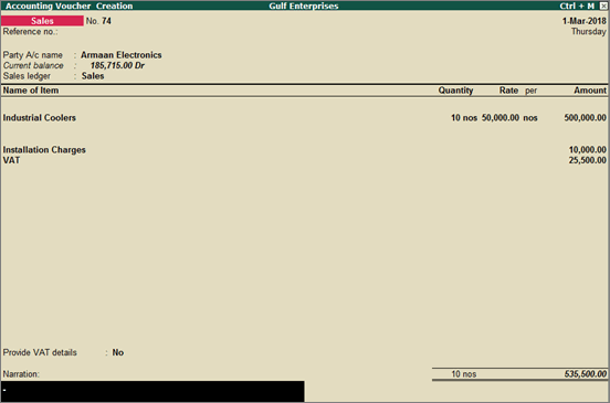

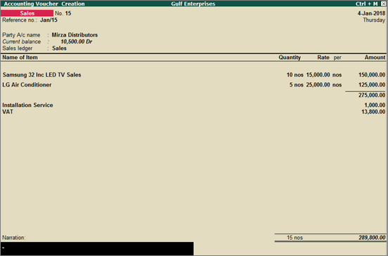

Record Sales with Additional Ledgers under GCC VAT
With Tally.ERP 9, you can appropriate the expenses incurred during a sale, to the value of the goods for calculating VAT.
Record sales with an additional ledger
2. In Party A/c name , select the customer ledger or the cash ledger.
4. Select the required stock items, and specify the quantities and rates.
5. Select the additional expense ledger and enter the amount. Ensure that the ledger is configured for inclusion in the calculation of VAT .
6. Select the VAT ledger.
7. Press Ctrl+A to accept.

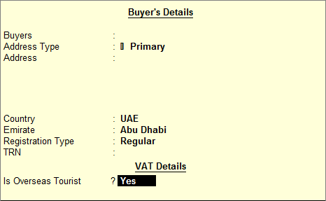

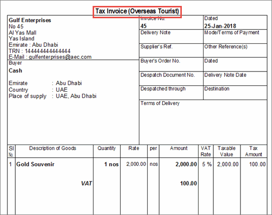

Sales made to Overseas Tourists
Sales made to overseas tourists are taxable at the point of sale. However, the tourist can claim the tax amount by showing the tax receipt before leaving the country.
To help identify sales made to overseas tourists, Tally.ERP has provided an option to mark a sale transaction as overseas tourist sale.
Mark a sales as overseas tourist sale
1. In the sales invoice, set the option Provide VAT details to Yes .
2. In the Statutory Details screen, enable the option Is Overseas Tourist? .
3. Press Ctrl+A to accept.
Mark a POS invoice as overseas tourist sale
1. In the POS invoice, select Not applicable in the Party A/c name field.
2. In the Party Details screen, enable the option Is Overseas Tourist?
3. Enter all the other details in the POS invoice.
4. Press Ctrl+A to accept.
Printing Overseas Tourist invoice
The title of the invoice print of the transaction recorded for sale to overseas tourist appears as shown:
