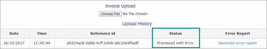

2.    For GSTR-1 and GSTR-2: The Status appears as Processed with Error while uploading invoices related to CDNR and CDNUR, even though the corresponding B2B invoices are present.
Cause
This error occurs when invoice numbers are already available in GSTR-1 or GSTR-2, or when there is a mismatch in tax details.
Solution
Download the error report from the GST portal.
In the GST Offline Tool:
1.    Go to the section Open Downloaded Error File from GST Portal and click Open.
2.    Enter the path on your computer where the error report is present.
3.    Note down the GSTINs and the associated invoice numbers.
On the GST portal (www.gst.gov.in):
1.    Go to Login > Return Dashboard.
2.    Select the period.
3.    Go to GSTR-2 > Prepare Online.
4.    Click the relevant section (B2B or CDNR).
5.    Select the relevant GSTIN and Invoice Number (Uploaded by Supplier/Uploaded by Tax Payer), and take the required action.

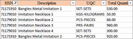

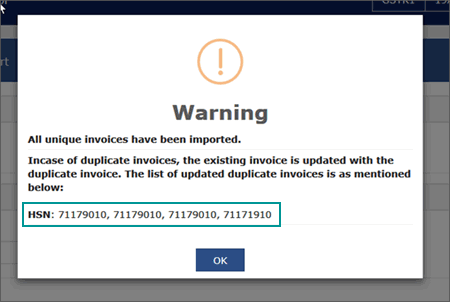

2.    When the combination of HSN code and its description is not unique, an error appears on the GST Offline Tool and GST portal.
This issue may occur when multiple UQCs are being used for a single HSN, and HSN Code - HSN Description combination is not unique for each UQC for a given HSN code.
Workaround:
     If you have used multiple UQCs for a single HSN, you have to modify the descriptions and keep the HSN Code - HSN Description combination unique for each UQC for a given HSN code. Follow the steps given below:
o     Note the HSN codes shown in the message. In this case, they are 71179010 and 71171910.
o     Open the Excel sheet or the CSV exported from Tally.ERP 9.
o     Search for these HSN Codes either by using filters on Excel or through manual search on the CSV.
o     Modify the description and make the HSN CodeDescription combination unique. In this example, you can add numerals (1, 2, 3, and so on).
o     Remove the filters and save the Excel sheet or CSV file.

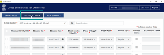

o     Delete all your data on the GST Offline Tool, if you would like to do a fresh import again.
o     Import the modified/corrected excel sheet or CSV file in the offline tool.

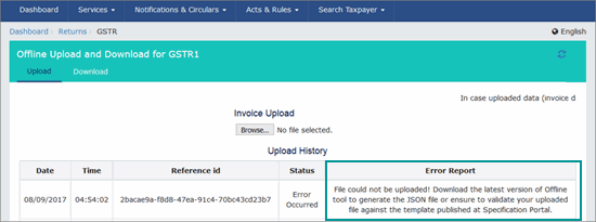

3.    Error: File could not be Uploaded! Download the latest version of Offline tool to generate the JSON file or ensure to validate your uploaded file against the template published at Specification Portal.
This error may appear while uploading the JSON file to the GST portal. Some of the possible reasons and the corresponding solutions are listed below:
     When Place of supply is selected as 97-Other Territory in the individual/summary invoices:
o     If you had incorrectly selected 97-Other Territory, then specify a different place of supply in Tally.ERP 9, and export the data again.
o     If you had deliberately selected 97-Other Territory, then, before importing the CSV and Excel sheets into the GST Offline Tool, you have to:
1.    Delete those transactions in which 97-Other Territory was selected as the place of supply.
2.    Import the remaining transactions into the GST Offline Tool.
3.    Manually enter these transactions on the GST portal.

     When HSN description is captured with more than 30 characters:
This issue does not occur for data exported from Tally. If you have manually entered data in CSV or Excel, you can follow either of these solutions:
o     Correct the data before uploading it to the GST Offline Tool for JSON creation.
o     Delete specific transactions from CSV or Excel sheets before uploading them to the GST Offline Tool for JSON creation. You will then have to manually enter these transactions on the GST portal.
     This error might also occur when you perform the following steps:
o     Download GSTR-1 invoices from the GST portal.
o     Open the invoices in the Offline Tool, delete or modify them, and generate a fresh JSON file.
o     Re-upload the JSON file to the GST Portal.
We have noted this issue and reported the same to the GSTN team for a possible resolution.
4.    Error: Errors encountered while uploading the files
This error occurs while uploading the JSON file to the portal using Internet Explorer browser. We have noted this issue and reported the same to the GSTN team for a possible resolution.
Workaround: Until this issue is resolved, we recommend that you use a different browser, for example Google Chrome, to upload the file to the GSTN portal.
