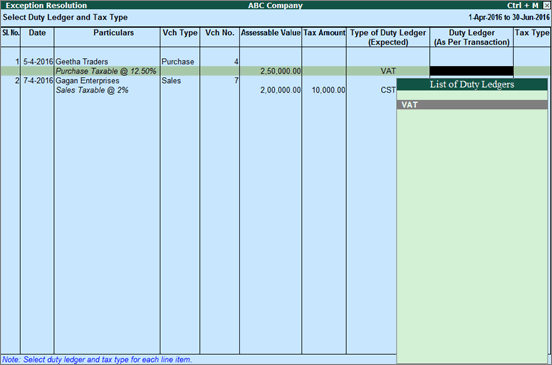

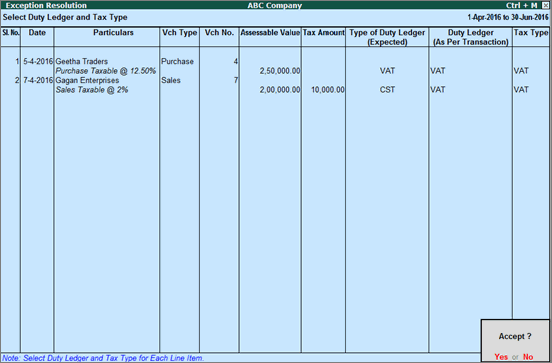

Incorrect tax type selected in tax ledger: Displays count of transactions in which type of duty is invalid.
