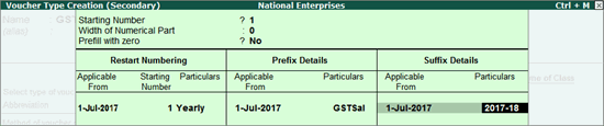

Use advanced configuration? - Yes, to open the Voucher Type Creation (Secondary) screen.
Starting Number - 1, if you want a fresh batch of voucher numbers.
Prefix Details, Suffix Details - Here you can enter details specific to your transactions, as required.
Now you can easily record your transactions with a new series of voucher numbers.

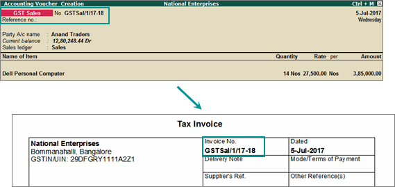

According to the details entered in the screen above, the sales voucher will appear as shown below:
Similarly, if you want to create invoices to track reverse charge transactions for unregistered dealers, create a new voucher type with a separate series of voucher numbers and record the purchase invoices. In the Voucher Printing screen, you can click F12: Configure and set the options as required to print the self-invoice.
