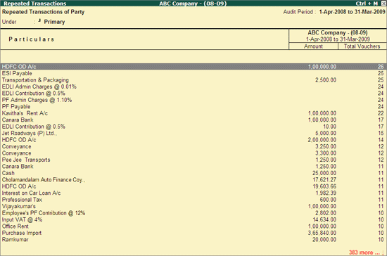

The repeated transactions report displays the Count of those Vouchers in which the Total Value is repeated more than once for any Ledger. The Auditor can filter the required information from this report and continue with further scrutiny.
To view the Repeated Transactions report
1. Go to Gateway of Tally > Audit & Compliance > Audit & Analysis > Repeated Transactions.
The above report displays the Ledger wise repetition details along with the repeated Amount. The Auditor can drill down from the above report to view the details of the ledger vouchers where the same amount is repeated more than twice.
Click F2: Period or press F2 to view the Repeated Value Transactions report for any required period.
Click F4: Group or press F4 to filter the view the Repeated Value Transactions report for the selected Group.
Click F8: Show Ledger or press F8 to display the ledger vouchers report for the selected Ledger.

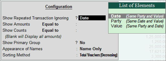

● Show Repeated Transactions Ignoring: Select the required option from Date (Same Party and Value), Party (Same Date and Value) and Value (Same Party and Date)
o Date (Same Party and Value) indicates that transactions having the same party and value will be displayed and the date of the transactions will be ignored.
o Party (Same Date and Value) will consider transactions having the same date and value and will ignore the party details.
o Value (Same Party and Date) will consider only those transactions with the same party and date and will ignore the value.
● Show Amounts: This option can be used to filter for Vouchers based on the transaction amount. Select the required option from equal to, greater than and lesser than and specify the required amount to display the Repeated Transactions report accordingly:
o equal to: displays Vouchers having transaction value equal to the amount specified.
o greater than: displays Vouchers having transaction value higher than the specified amount.
o lesser than: displays Vouchers having transaction value lesser than the specified amount.
● Show Counts: Select the required option from equal to, greater than and lesser than and specify the required count (number of times a transaction has been repeated) to display the Repeated Transactions report accordingly:
o equal to: displays transactions that have been repeated for a given number of times.
o greater than: displays transactions that have been repeated for more than the specified number of times.
o lesser than: displays transactions that have been repeated for less than the specified number of times.
Note: In the above screen, all the Vouchers where total amount is greater than 1000 will be displayed in the report once the configuration is saved.
● Show Name of Group: Set this option to Yes to display the name of the immediate Group/Subgroup
● Show Primary Group: Set this option to Yes to display the name of the Primary Group
● Appearance of Names: Select the required Display Name for the Ledgers
● Sorting Method: Select the required sorting method to display the report as per the Amount-wise, Alphabetical, Total Vouchers and so on.
