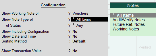

In F12: Configuration, few configuration options will be displayed based on the Working Note Level selected.
● Show Working Note of: Select the required Working Note Level (from Company, Masters, Vouchers and All) to filter and display Audit Working Paper for the selected Working Note Level.
● Show Note Type of: Select the required Note type, Audit/Verify Notes, Future Ref. Notes, Working Notes and All Items for Company/Masters/Vouchers/All to filter and display notes for the selected Note Type.
● Of Status: Select to filter the information for the Note Type already selected. Cursor will move to Of Status field, for the Note Types Masters and Vouchers. You can view the Notes of the following status.
o Masters for On Hold or Altered or Audited or Clarified or Need clarification or Restored or Under Observation.
o Vouchers for On Hold or Altered or Restored or Verified.
● Show Including Configuration: Set this option to Yes to view the working paper with actions such as apply, alter, delete, restore default of configurations like MSME, Related Party, Sampling, Periodic Payments.
Note: All system copied activities like restore, delete, apply sampling etc. will be displayed in Italics.
● Show Date and Time: Set this option to Yes to display the Date and Time of entry of Audit/Working notes.
● Sorting Method: Select the appropriate sorting method form the Sorting Methods. Depending on the Working Note Level (Company/Voucher/Masters) selected the sorting methods displayed for selection will differ. This option will not be displayed in F12: Configuration if the Working Note Level selected for the option Show Working Note of is All.
● Show Transaction Value: Set this option to Yes to view the transaction value of the voucher . This option will be displayed in F12: Configure only for the Working Note Level Vouchers.

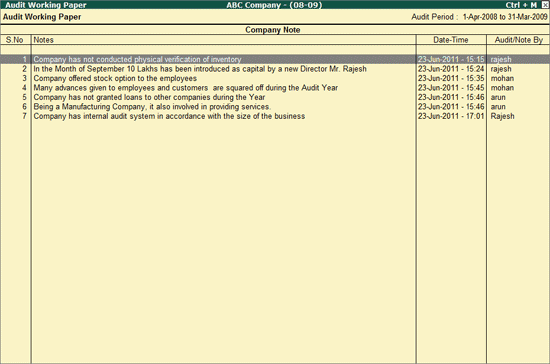

The Audit Working Paper configured to view only the Company Note is displayed as shown below:
Audit Working Paper for Company Note will display the details of Notes, Date-Time, along with the Name of the auditor(s)/article(s) who entered the Working/Audit note.
Note: Date and Time of entry of Audit Note will be displayed only when the option Show Date and Time is set to Yes.
