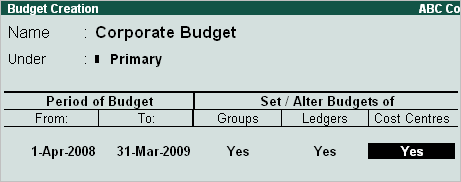

1. Go to Gateway of Tally > Accounts Info. > Budgets > Create.
2. In the Budget Creation screen, enter a Name for your budget.
3. Enable budgets for groups, and ledgers if required.
4. Set the option Cost Centres to Yes to view the Cost Centre Budget screen.

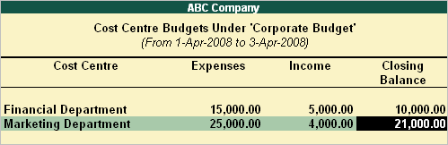

5. Enter a budget figure in Expenses for the cost centre.
6. Enter a budget figure in Income for the cost centre.
7. Enter Closing Balance.
The Cost Centre Budget screen appears as shown below:
8. Press Enter.
9. Press Enter to save the budgets created.
